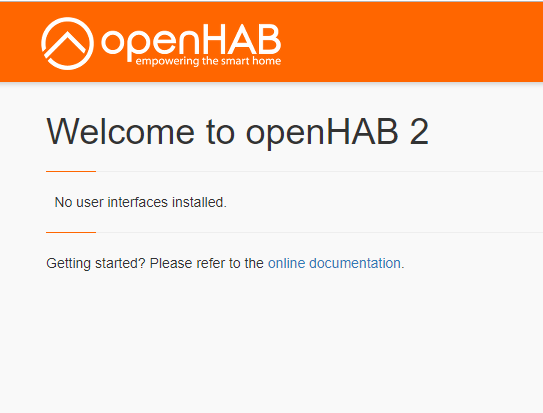

Well, I sort of gave up and reinstalled OpenHAB, then copied my configuration files back over. That seemed to go well and the log files indicate happiness, however when I opened the web interface I was prompted to set up UI. I inadvertently blew past this and now I get the screen:
and I’m unsure how to add PaperUI or any of the others!
solved that problem:
For those looking for the command:
sudo openhab-cli reset-ownership
This came in quite useful for myself previously.
