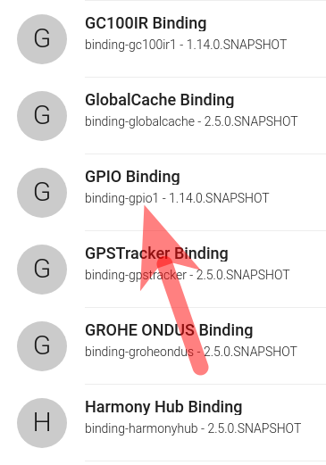

If you’ve added it in addons.cfg you should use gpio1 instead. It’s a 1.x binding:

I’ve uninstalled the binding via the PAPER UI and re-installed it again, will see if the problem exist. Is that wht you did to resolve your issue.

Then the issue is that its part of:
/var/lib/openhab2/config/org/openhab/addons.config
It’ll probably be solved if you remove it from that file and restart openHAB.
oh ok I get you. I thought you were referring to the /etc/openhab2/services/addons.cfg .
My file (/var/lib/openhab2/config/org/openhab/addons.config) was
binding="mqtt1,yahooweather,ntp,expire1,gpio,network,samsungtv,icloud,souliss1,astro,onkyo,mqtt,gpio1"
now I removed the gpio, but kept the gpio1.
