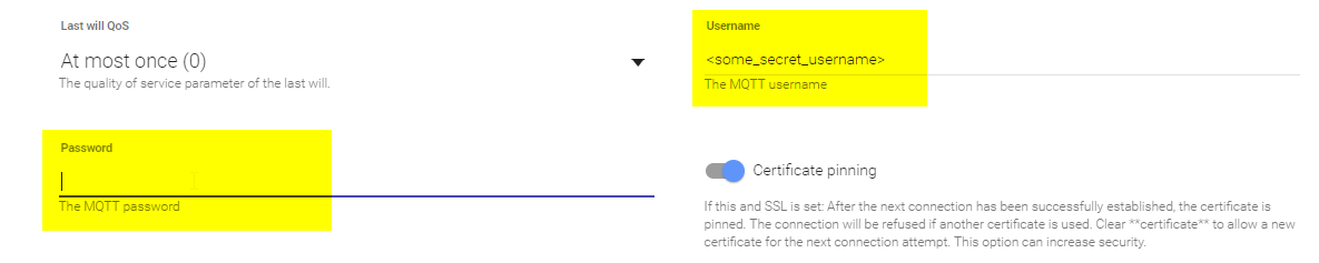

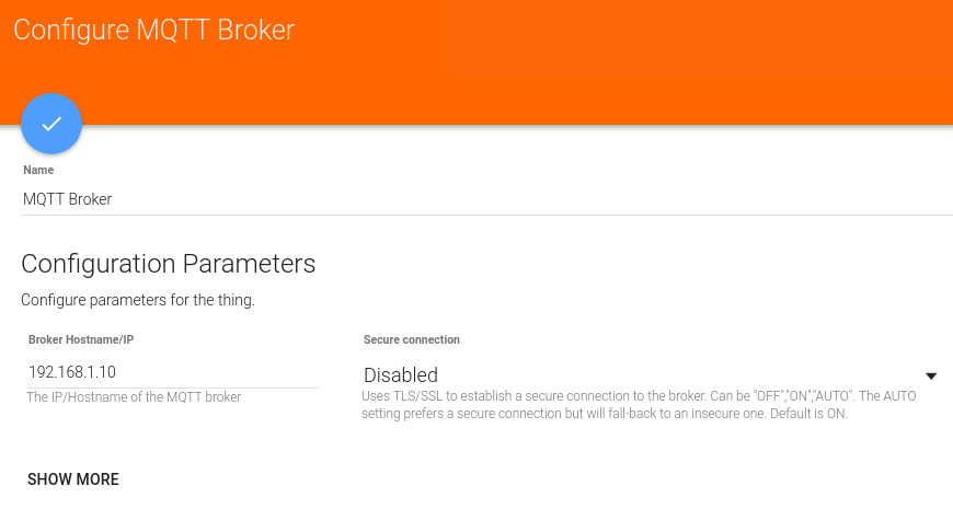

PaperUI (for MQTT 2.4)

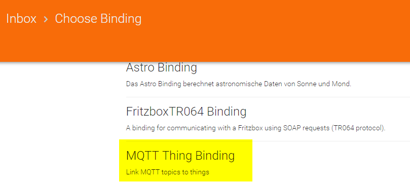

Go to the inbox, add a new thing and select MQTT Thing Binding:

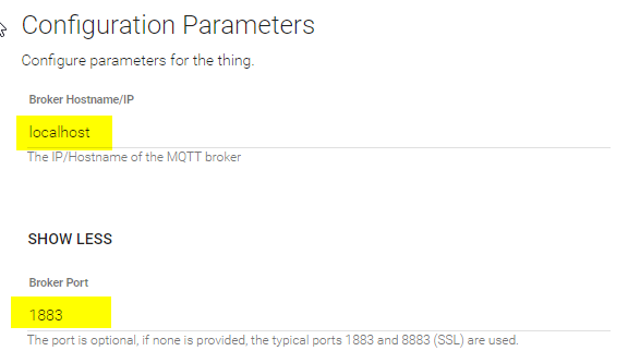

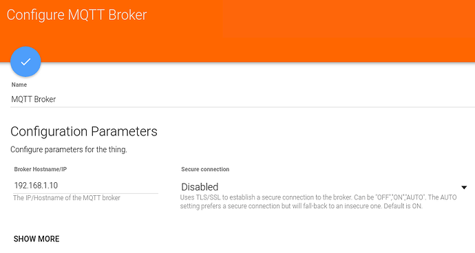

Next, you need to define a connection to your broker. Select MQTT broker and use the data that you also have used with the MQTT 1 binding
When you now save the thing, it should go to online (I’ve named my thing Mosquitto)

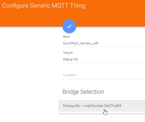

Step 1: Add a new thing in PaperUI and select a Generic MQTT Thing
Step 2: Give it a proper name (e.g. Sonoff4CH_Garden_Left) and select your previously defined broker

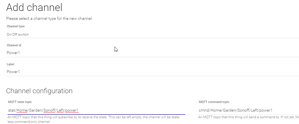

Step3: Go to the thing and add a new channel. For the Outlet in the example, a ON/OFF switch is sufficient:
A word for the channel ID and the Label: I tend to keep them the same which makes it easy to identify afterwards.
Step 3: Configure the MQTT topic for state and command and save this thing:

Small tip: In step 2 also add Give it a proper Thing Id too
For example:
Thing Name: Sonoff4CH_Garden_Left
Thing Id: Sonoff4CHGardenLeft
This way, the channels are human readable in the items file:
mqtt:topic:Sonoff4CHGardenLeft:Power
instead of
mqtt:topic:08c64b74:Power
This is very useful because when reading the item file, I want to know what device my item is linked to.
Using human readable Thing Ids goes a long way to achieve that.

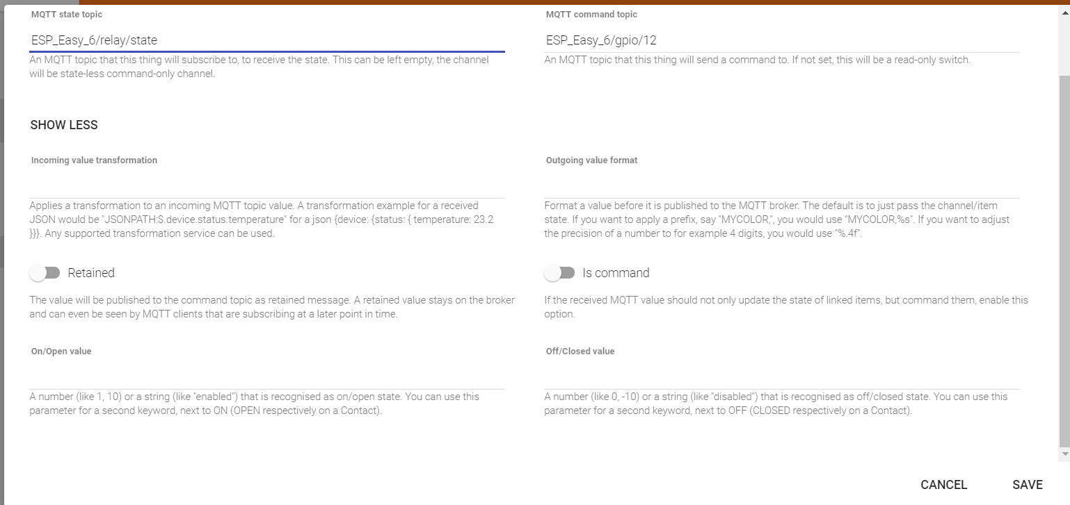

i have followed your guide and cant not seem to make it work… I have a test sonoff basic item:
Switch mqtt6 "mqtt6"   {mqtt=">[broker:/ESP_Easy_6/gpio/12:command:ON:1],>[broker:/ESP_Easy_6/gpio/12:command:OFF:0],<[broker:/ESP_Easy_6/relay/state:state:MAP(onoff.map)]"}
i use a simple transformation 1=on and 0=off
that with old mosquito binding work like a charm.
Trying to migrate it to the new way but it doesnt work at all.This is my channel
What am i doing wrong?After i save i get “Status: OFFLINE - COMMUNICATION_ERROR java.lang.Exception: No MQTT client”
You did everything right. This is a know bug fixed in oh 2.5 snapshot.
