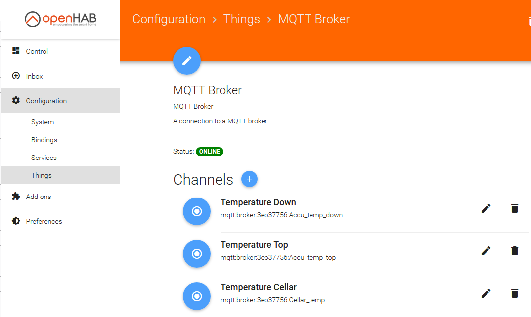

Im paperUI i configured the mqtt-binding and some channels to read the temperature from ESPeasy sensors. This work without problems, as see from events.log:
2019-04-10 08:59:33.064 [vent.ChannelTriggeredEvent] - mqtt:broker:3eb37756:Accu_temp_top triggered 35.81
2019-04-10 08:59:34.112 [vent.ChannelTriggeredEvent] - mqtt:broker:3eb37756:Accu_temp_down triggered 29.31
2019-04-10 08:59:55.039 [vent.ChannelTriggeredEvent] - mqtt:broker:3eb37756:Cellar_temp triggered 13.13

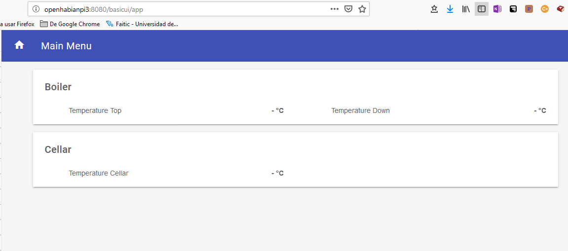

But in ‘http://openhabianpi3:8080/basicui/app’ I don’t see any temperature values. What i missing?

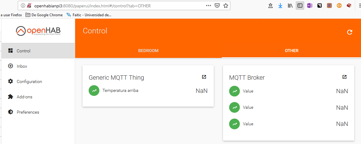

BTW, im paperui control tab i don’t see the right values, only channels with NaN as value. I can’t attach the screen shot.

You configured the needed channels on the broker thing. This one does ONLY connect openhab to the mqtt broker, no channels needed here.
Create a generic MQTT thing with those channels.

That is what i see on the site map:

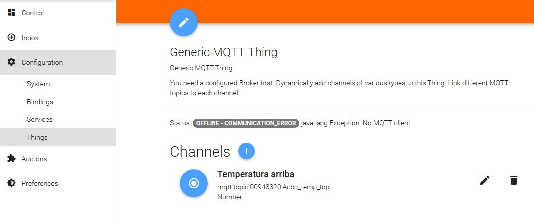

I tried this way, with the Generic MQTT Thing, but then i got communication error:
The configuration of generic MQTT thing is simple:

Great! Some openHAB restarts and added new things to generic MQTT things and i can see the temperature values on the control tab
But the http://openhabianpi3:8080/basicui/app is not working yet.
I will try to configure the files as @allen suggested.
If the things and items are working, I would leave it. The BasicUI problems might only be related to the sitemap file. Look there first!
Are you using VSCode as an editor for those files? Syntax problems would be highlighted there.
