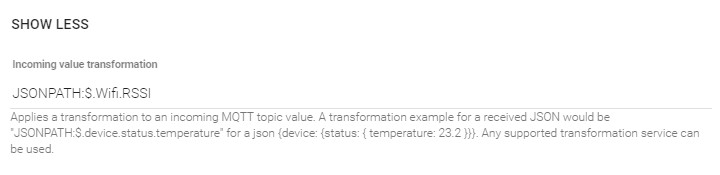

I’ve had the WiFi quality of my sonoff device with:
JSONPATH($.Wifi.RSSI)
and with the new binding it looks like:
That means, your’s should be
JSONPATH:$.actual
