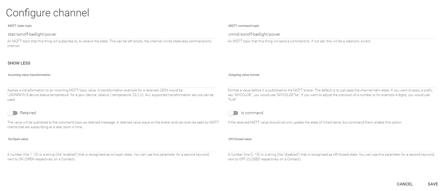

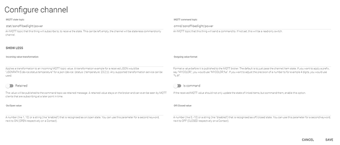

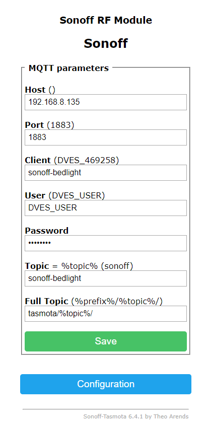

EDIT (added SONOFF MQTT Config Screen):
Thanks @kaju666
