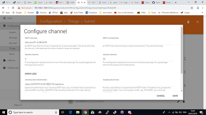

getting this error with my setup not sure whats wrong it reading but not getting temp in
2019-01-20 15:39:53.111 [WARN ] [eneric.internal.generic.ChannelState] - Incoming payload ‘{“Time”:“2019-01-20T16:39:53”,“DS18B20”:{“Temperature”:17.9},“TempUnit”:“C”}’ not supported by type ‘NumberValue’
state:JSONPATH:$.DS18B20.Temperature
thanks for that another typo from me been trying for 2 days to get that working

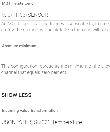

I could setup by copying data from my old MQTT items for my sonoff TH03 sensor SI7021 for temperature but unfortunatelly not for humidity - Any Idea what i do miss, I tried the channel setting for text, number and percentage - all seems not working for humidity.
For the temperature is use “number”.
This is the non-working channel setting for the humidity
and this is the working setting for the temperature
This are my items:
Number TH03TEMP {channel=“mqtt:topic:TH03TEMP:TH03TEMP”}
Number TH03HUM {channel=“mqtt:topic:TH03HUM:TH03HUM”}
and this is my sitemap for the both entries:
Text item=TH03Temp label=“TH03Temp [%.1f °C]” icon=“temperature”
Text item=TH03Hum label=“TH03Hum [%.1f %% ]” icon=“humidity”

Sou are using the channel “mqtt:topic:TH03TEMP:TH03TEMP” for the temperature, that would suggest a thing-name of TH03TEMP, according the used stateTopic I would think the name is “TH03”. But since you do get temperature readings lets assume your channel is correct. The humidity sensor should be using the same thing-name.
I was creating 3 things for the TH03 and the sensor S7021 attached, one for the switch, one for the temperature and one for humidity. For each I was adding one channel.
Currently the switch and temperature are working.
You suggest to use the thing for temperature, and add a second channel for the humidity to that temperature thing, right?
I suggest one thing for the THING. The sonoff is one thing. One physical thing. One piece of hardware.
Then add 3 channels. The switch, the temperature and the humidity to that one thing.
This will help you manage your things. One piece of kit = One thing.
