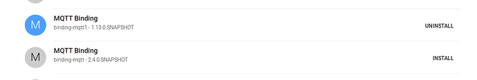

It appears that there is a new 2.4 MQTT binding:
Has anyone got info about it. Clicking on the binding gives me a 404 error…
