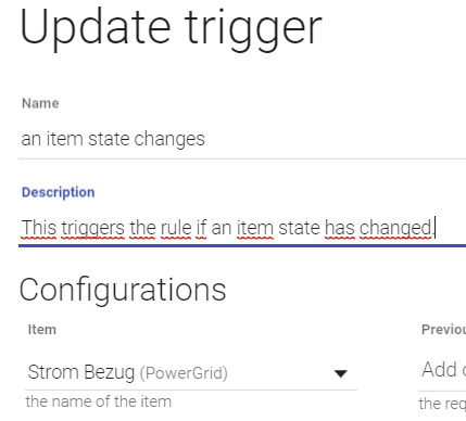

I’m using as a trigger the update of the PowerGrid item of my Fronius inverter. This updates every 10 seconds.

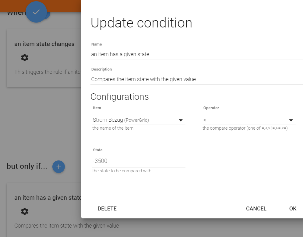

But I only want the Tesla to start charging if there’s enough power produced by my solar roof and available to be used for charging. I configured my Tesla to charge with 5A which means it will need at least 3450 W power. Therefore I’m including an additional condition (“but only if”) which checks that the PowerGrid item is less than 3500 W - which means that it’s putting more than 3500 W into the grid.

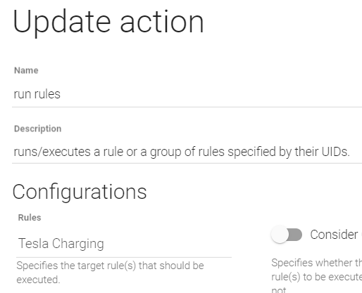

I implemented my rules in a way that they act independently from each other:
I have one rule that checks if enough energy is put into the grid. If that’s the case it triggers another rule that starts the charging of the car.
