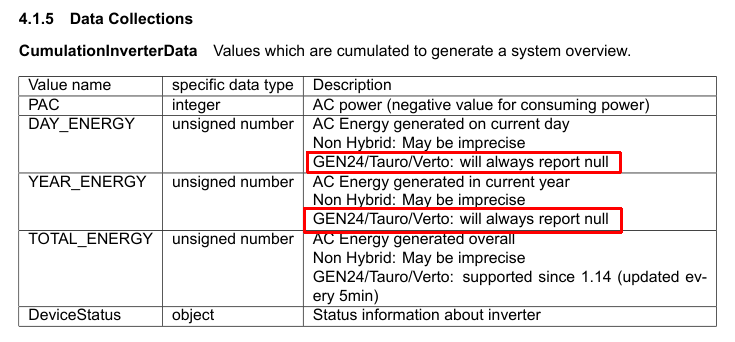

Fronius Symo GEN24 8.0 PLUS, no values for Channel inverterdatachanneldayenergy (Energy generated on current day)
I have the above mentioned inverter. No values are provided for the channel
inverterdatachanneldayenergy (energy generated on the current day) or for inverterdatachannelyear (energy generated in the current year). However, values are provided for other channels, such as inverterdatachanneltotal (energy generated overall) and others.
Does anyone have any idea what might be causing this?

Here is a trace log. It is noticeable that the values for inverterdatachanneldayenergy and inverterdatachannelyear are 0. The other values are there.
trace.log (118.1 KB)
Perhaps it’s also worth mentioning that when I set the binding to debug, no messages are created in openhab.log?
I found the solution in the Fronius API documentation:
Do you want to update the docs?
At the bottom of the Fronius binding documentation, there is link to update the docs.
Done!
