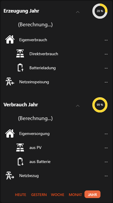

Fronius Widget for Generation and Consumption including Rules
I tried to create a widget that is similar to the Solar.Web app, but with the advantage that the data is stored locally and is therefore recorded even if there is an internet outage.

and my item to control extended logging, but you can leave this out, you just have to adjust the rules:
Switch Advanced_Logging "Erweiterte Logs"
The PV_Sum* items are stored by me in the influxdb, their values ​​are obtained from the corresponding rules.

// Summen-Items Konfiguration
const SUM_ITEMS = {
    gridDraw: 'PV_Sum_GridDraw',
    gridFeed: 'PV_Sum_GridFeed',
    load: 'PV_Sum_Load',
    batteryCharge: 'PV_Sum_BatteryCharge',
    batteryDischarge: 'PV_Sum_BatteryDischarge',
    production: 'PV_Sum_Production'
// Logger-Funktion
const log = (message, level = 'info') => {
    const advancedLogging = items.getItem('Advanced_Logging').state === 'ON';
    if (advancedLogging || level === 'error') {
        // Alles als INFO oder höher loggen für bessere Sichtbarkeit
        switch(level) {
            case 'debug': console.log('[DEBUG] ' + message); break;
            case 'warn': console.warn(message); break;
            case 'error': console.error(message); break;
            default: console.log(message);
const formatDateTime = timestamp => {
    const date = new Date(timestamp);
    return date.toLocaleString('de-DE', {
        timeZone: 'Europe/Berlin',
        year: 'numeric',
        month: '2-digit',
        day: '2-digit',
        hour: '2-digit',
        minute: '2-digit',
        second: '2-digit'
// Zeit-Funktionen
const getTimeRange = (zeitraum) => {
    const zoneId = ZoneId.of(TIMEZONE);
    const now = JavaZDT.now(zoneId);
    const dataCollectionStart = JavaZDT.of(2025, 2, 19, 14, 0, 0, 0, zoneId);
    // Hilfsfunktion für Tagesstart/-ende
    const startOfDay = (date) => date.withHour(0).withMinute(0).withSecond(0).withNano(0);
    const endOfDay = (date) => date.withHour(23).withMinute(59).withSecond(59).withNano(999999999);
    let startTime, endTime;
    switch(zeitraum.toLowerCase()) {
        case 'heute':
            startTime = startOfDay(now);
            endTime = now;
            break;
        case 'gestern':
            startTime = startOfDay(now.minusDays(1));
            endTime = endOfDay(now.minusDays(1));
            break;
        case 'woche':
            startTime = startOfDay(now.minusWeeks(1).with(ChronoField.DAY_OF_WEEK, 1));
            endTime = now;
            break;
        case 'monat':
            startTime = startOfDay(now.withDayOfMonth(1));
            endTime = now;
            break;
        case 'jahr':
            startTime = startOfDay(now.withDayOfYear(1));
            endTime = now;
            break;
        default:
            endTime = now;
    // Debug-Ausgabe vor der Anpassung
    log(`Ursprünglicher Zeitraum für ${zeitraum}:`, 'debug');
    log(`  Start: ${formatDateTime(startTime.toInstant().toEpochMilli())}`, 'debug');
    log(`  Ende:  ${formatDateTime(endTime.toInstant().toEpochMilli())}`, 'debug');
    // Startzeit nicht vor Datenerfassungsbeginn
    if (startTime.isBefore(dataCollectionStart)) {
        startTime = dataCollectionStart;
        log(`Startzeit auf Datenerfassungsbeginn angepasst: ${formatDateTime(startTime.toInstant().toEpochMilli())}`, 'debug');
    // Debug-Ausgabe nach der Anpassung
    log(`Finaler Zeitraum ${zeitraum}:`, 'debug');
    return [startTime, endTime];
// Hilfsfunktion zum Aktualisieren der Anzeige-Items
const updateDisplayItems = (values) => {
    try {
        // Debug vor dem Update
        log('Starte Update der Display-Items mit folgenden Werten:', 'debug');
        Object.entries(values).forEach(([key, value]) => {
            log(`${key}: ${value}`, 'debug');
        // Formatierungsfunktion für Energiewerte
        const formatValue = value => value < 1
            ? `${(value * 1000).toFixed(1)} Wh`
            : `${value.toFixed(2)} kWh`;
        // Basis-Werte mit Formatierung
        items.getItem('PV_Erzeugung').postUpdate(formatValue(values.erzeugung));
        items.getItem('PV_Eigenverbrauch').postUpdate(formatValue(values.eigenverbrauch));
        items.getItem('PV_Direktverbrauch').postUpdate(formatValue(values.direktverbrauch));
        items.getItem('PV_Batterieladung').postUpdate(formatValue(values.batterieladung));
        items.getItem('PV_Netzeinspeisung').postUpdate(formatValue(values.netzeinspeisung));
        items.getItem('PV_Gesamtverbrauch').postUpdate(formatValue(values.gesamtverbrauch));
        items.getItem('PV_Eigenversorgung').postUpdate(formatValue(values.eigenversorgung));
        items.getItem('PV_EigenversorgungPV').postUpdate(formatValue(values.eigenversorgungPV));
        items.getItem('PV_EigenversorgungBatterie').postUpdate(formatValue(values.eigenversorgungBatterie));
        items.getItem('PV_Netzbezug').postUpdate(formatValue(values.netzbezug));
        // Prozentwerte immer berechnen und mit 0 initialisieren
        const prozentWerte = {
            eigenverbrauchProzent: 0,
            direktverbrauchProzent: 0,
            batterieladungProzent: 0,
            netzeinspeisungProzent: 0,
            eigenversorgungProzent: 0,
            eigenversorgungPVProzent: 0,
            eigenversorgungBatterieProzent: 0,
            netzbezugProzent: 0
        // Berechnung basierend auf Erzeugung
        if (values.erzeugung > MINIMAL_POWER_THRESHOLD) {
            prozentWerte.eigenverbrauchProzent = Math.round((values.eigenverbrauch / values.erzeugung) * 100);
            prozentWerte.direktverbrauchProzent = Math.round((values.direktverbrauch / values.erzeugung) * 100);
            prozentWerte.batterieladungProzent = Math.round((values.batterieladung / values.erzeugung) * 100);
            prozentWerte.netzeinspeisungProzent = Math.round((values.netzeinspeisung / values.erzeugung) * 100);
        // Berechnung basierend auf Gesamtverbrauch
        if (values.gesamtverbrauch > MINIMAL_POWER_THRESHOLD) {
            // Effektive Werte berechnen
            const effectiveNetzbezug = values.netzbezug < MINIMAL_POWER_THRESHOLD ? 0 : values.netzbezug;
            const effectiveBatterie = values.eigenversorgungBatterie;
            const effectivePV = values.eigenversorgungPV;
            // Prozentwerte berechnen
            let batterieProzent = Math.round((effectiveBatterie / values.gesamtverbrauch) * 100);
            let pvProzent = Math.round((effectivePV / values.gesamtverbrauch) * 100);
            let netzbezugProzent = Math.round((effectiveNetzbezug / values.gesamtverbrauch) * 100);
            // Sicherstellen, dass die Summe 100% nicht übersteigt
            const total = batterieProzent + pvProzent + netzbezugProzent;
            if (total > 100) {
                // Proportionale Anpassung
                const factor = 100 / total;
                batterieProzent = Math.round(batterieProzent * factor);
                pvProzent = Math.round(pvProzent * factor);
                netzbezugProzent = 100 - batterieProzent - pvProzent;
            // Wenn fast alles aus der Batterie kommt
            if (batterieProzent > 95 && netzbezugProzent < 5) {
                batterieProzent = 100;
                netzbezugProzent = 0;
                pvProzent = 0;
            prozentWerte.eigenversorgungProzent = batterieProzent + pvProzent;
            prozentWerte.eigenversorgungBatterieProzent = batterieProzent;
            prozentWerte.eigenversorgungPVProzent = pvProzent;
            prozentWerte.netzbezugProzent = netzbezugProzent;
        // Update der Prozentwerte
        items.getItem('PV_EigenverbrauchProzent').postUpdate(prozentWerte.eigenverbrauchProzent);
        items.getItem('PV_DirektverbrauchProzent').postUpdate(prozentWerte.direktverbrauchProzent);
        items.getItem('PV_BatterieladungProzent').postUpdate(prozentWerte.batterieladungProzent);
        items.getItem('PV_NetzeinspeisungProzent').postUpdate(prozentWerte.netzeinspeisungProzent);
        items.getItem('PV_EigenversorgungProzent').postUpdate(prozentWerte.eigenversorgungProzent);
        items.getItem('PV_EigenversorgungPVProzent').postUpdate(prozentWerte.eigenversorgungPVProzent);
        items.getItem('PV_EigenversorgungBatterieProzent').postUpdate(prozentWerte.eigenversorgungBatterieProzent);
        items.getItem('PV_NetzbezugProzent').postUpdate(prozentWerte.netzbezugProzent);
        log('Display-Items erfolgreich aktualisiert', 'debug');
    } catch (error) {
        log(`Fehler beim Update der Display-Items: ${error}`, 'error');
const calculateCurrentValues = async (startTime, endTime) => {
    try {
        log(`Berechne Werte von ${startTime} bis ${endTime}`, 'debug');
        // Konvertiere zu DateTimeType für die Persistence-Abfrage
        const startDateTime = startTime;
        const endDateTime = endTime;
        log(`Konvertierte Zeiten - Start: ${startDateTime}, End: ${endDateTime}`, 'debug');
        // Hole die Werte mit den konvertierten Zeiten
        const itemStates = await Promise.all(
            Object.values(SUM_ITEMS).flatMap(itemName => [
                actions.PersistenceExtensions.persistedState(
                    items.getItem(itemName),
                    endDateTime,
                    'influxdb'
                ).state,
                    startDateTime,
                    'influxdb'
                ).state
        // Differenzberechnung mit verbessertem Debugging
        const getDifference = (index) => {
            const endState = itemStates[index * 2];
            const startState = itemStates[index * 2 + 1];
            const itemName = Object.values(SUM_ITEMS)[index];
            const parseValue = (state) => {
                if (!state) return 0;
                const rawValue = state.toString().split(' ')[0];
                return parseFloat(rawValue);
            const endValue = parseValue(endState);
            const startValue = parseValue(startState);
            const difference = Math.max(0, endValue - startValue);
            log(`${itemName}: ${startValue} → ${endValue} = ${difference} kWh`, 'debug');
            return difference;
        // Werte extrahieren
        const gridDraw = getDifference(0);
        const gridFeed = getDifference(1);
        const load = getDifference(2);
        const batteryCharge = getDifference(3);
        const batteryDischarge = getDifference(4);
        const production = getDifference(5);
        // Zwischen-Log der Rohdifferenzen
        log('Rohe Differenzwerte:', 'debug');
        log(`Load (Verbrauch): ${load} kWh`, 'debug');
        log(`Production: ${production} kWh`, 'debug');
        log(`Grid Feed: ${gridFeed} kWh`, 'debug');
        log(`Battery Charge: ${batteryCharge} kWh`, 'debug');
        log(`Battery Discharge: ${batteryDischarge} kWh`, 'debug');
        // Basiswerte berechnen
        const values = {
            netzbezug: gridDraw,
            netzeinspeisung: gridFeed,
            batterieladung: batteryCharge,
            eigenversorgungBatterie: batteryDischarge,
            direktverbrauch: Math.max(0, production - gridFeed - batteryCharge),
            verbrauch: load  // Rohwert zum Vergleich
        // Zwischen-Log der Basiswerte
        log('Berechnete Basiswerte:', 'debug');
            log(`${key}: ${value.toFixed(3)} kWh`, 'debug');
        // Abgeleitete Werte berechnen
        values.eigenverbrauch = values.direktverbrauch + values.batterieladung;
        values.erzeugung = values.netzeinspeisung + values.eigenverbrauch;
        values.eigenversorgungPV = values.direktverbrauch;
        values.eigenversorgung = values.eigenversorgungPV + values.eigenversorgungBatterie;
        values.gesamtverbrauch = values.eigenversorgung + values.netzbezug;
        // Final-Log der abgeleiteten Werte
        log('Abgeleitete Werte:', 'debug');
        // Plausibilitätscheck
        log('Plausibilitätsprüfung:', 'debug');
        log(`Gesamtverbrauch = Eigenversorgung + Netzbezug: ${values.gesamtverbrauch.toFixed(3)} = ${values.eigenversorgung.toFixed(3)} + ${values.netzbezug.toFixed(3)}`, 'debug');
        log(`Erzeugung = Netzeinspeisung + Eigenverbrauch: ${values.erzeugung.toFixed(3)} = ${values.netzeinspeisung.toFixed(3)} + ${values.eigenverbrauch.toFixed(3)}`, 'debug');
        return values;
    } catch (error) {
        log(`Fehler bei der Berechnung der aktuellen Werte: ${error}`, 'error');
        return null;
// Hauptregel für die Berechnungen
const pvRule = rules.JSRule({
    name: "PV-Anlage Berechnung",
    description: "Berechnet PV-Anlagen Werte",
    triggers: [
        triggers.SystemStartlevelTrigger(100),
        triggers.GenericCronTrigger("0 */5 * * * ?"),    // Alle 5 Minuten
        triggers.GenericCronTrigger("0 1 0 * * ?"),      // 1 Minute nach Mitternacht
        triggers.ItemStateChangeTrigger("PV_Zeitraum")
    execute: async (event) => {
        try {
            // Kurze Verzögerung nach Mitternacht
            if (event.triggerType === 'GenericCronTrigger' &&
                event.triggerConfig === "0 1 0 * * ?") {
                await new Promise(resolve => setTimeout(resolve, 5000));
            const zeitraum = items.getItem('PV_Zeitraum').state;
            const [startTime, endTime] = getTimeRange(zeitraum);
            const values = await calculateCurrentValues(startTime, endTime);
            if (values) {
                updateDisplayItems(values);
                log(`Werte für ${zeitraum} aktualisiert`);
        } catch (error) {
            log(`Fehler in der PV-Regel: ${error}`, 'error');
and here is the widget code:

  default:
    - component: f7-row
        style:
          align-items: center
          margin-bottom: 5px
          margin-left: 10px
        default:
          - component: f7-col
              style:
                white-space: nowrap
              width: 75
              default:
                - component: Label
                    style:
                      font-size: 1.2em
                      font-weight: bold
                    text: ="Erzeugung " + items[props.periodItem].state.charAt(0).toUpperCase() +
                      items[props.periodItem].state.slice(1)
          - component: f7-col
              style:
                display: flex
                justify-content: flex-end
                margin-top: 10px
                padding-right: 5px
              width: 25
              default:
                - component: oh-gauge
                    bgColor: transparent
                    borderBgColor: "#e0e0e0"
                    borderColor: "#FDD835"
                    borderWidth: 8
                    item: =props.eigenverbrauchProzentItem
                    labelFontSize: 8
                    labelTextColor: var(--f7-text-color)
                    type: circle
                    valueFontSize: 10
                    valueTextColor: var(--f7-text-color)
    - component: f7-row
        style:
          margin-bottom: 15px
          margin-left: 60px
          margin-top: -5px
          text-align: center
        default:
          - component: Label
              style:
                color: "=(themeOptions.dark == 'dark') ? 'white' : 'black'"
                font-size: 1.3em
                font-weight: 500
              text: =items[props.erzeugungItem].state
    - component: f7-list
        noHairlines: true
        noHairlinesBetween: true
        default:
          - component: oh-list-item
              icon: f7:house_fill
              style:
                --oh-list-item-title-font-size: 1.1em
              title: Eigenverbrauch
              after:
                - component: Label
                    style:
                    text: =items[props.eigenverbrauchItem].state
              icon: material:solar_power
              style:
                --oh-list-item-media-margin: 10px
                --oh-list-item-title-font-size: 1em
                margin-left: 35px
              title: Direktverbrauch
              after:
                - component: Label
                    style:
                    text: =items[props.direktverbrauchItem].state
              icon: "=(themeOptions.dark == 'dark') ? 'to_battery' : 'to_battery_dark'"
              style:
                margin-left: 35px
              title: Batterieladung
              after:
                - component: Label
                    style:
                    text: =items[props.batterieladungItem].state
              icon: "=(themeOptions.dark == 'dark') ? 'to_grid' : 'to_grid_black'"
              style:
              title: Netzeinspeisung
              after:
                - component: Label
                    style:
                    text: =items[props.netzeinpeisungItem].state
    - component: f7-row
        style:
          align-items: center
          margin: 20px 0 5px 0
          margin-left: 10px
        default:
          - component: f7-col
              style:
                white-space: nowrap
              width: 75
              default:
                - component: Label
                    style:
                      font-size: 1.2em
                      font-weight: bold
                    text: ="Verbrauch " + items[props.periodItem].state.charAt(0).toUpperCase() +
          - component: f7-col
              style:
                display: flex
                margin-top: 10px
                padding-right: 5px
              width: 25
              default:
                    borderWidth: 8
                    item: =props.eigenversorgungProzentItem
                    labelFontSize: 8
                    type: circle
                    valueFontSize: 10
    - component: f7-row
        style:
          margin-bottom: 15px
          margin-left: 60px
          margin-top: -5px
          text-align: center
        default:
          - component: Label
              style:
                font-size: 1.3em
                font-weight: 500
              text: =items[props.gesamtverbrauchItem].state
        noHairlines: true
        default:
              icon: f7:house_fill
              style:
              title: Eigenversorgung
              after:
                - component: Label
                    style:
                    text: =items[props.eigenversorgungItem].state
              style:
                margin-left: 35px
              title: aus PV
              after:
                - component: Label
                    style:
                    text: =items[props.eigenversorgungPVItem].state
              icon: "=(themeOptions.dark == 'dark') ? 'from_battery' : 'from_battery_dark'"
              style:
                margin-left: 35px
              title: aus Batterie
              after:
                - component: Label
                    style:
                    text: =items[props.eigenversorgungBatterieItem].state
              icon: "=(themeOptions.dark == 'dark') ? 'from_grid' : 'from_grid_black'"
              style:
              title: Netzbezug
              after:
                - component: Label
                    style:
                    text: =items[props.netzbezugItem].state
    - component: f7-row
        style:
          display: flex
          justify-content: center
          margin-bottom: 10px
          margin-top: 10px
        default:
          - component: f7-block
              style:
                display: flex
                flex-wrap: wrap
                gap: 1px
                margin-bottom: 0
                padding-bottom: 0
              default:
                - component: oh-repeater
                    for: button
                    fragment: true
                    in: =props.buttons.split(',')
                    default:
                      - component: oh-button
                          action: command
                          actionCommand: =loop.button.split(';')[0]
                          actionItem: =props.periodItem
                          fill: =items[props.periodItem].state === loop.button.split(';')[0]
                          style:
                            font-size: 0.9em
                            height: 26px
                            line-height: 22px
                            margin: 1px
                            min-width: 55px
                            padding: 2px 6px
                          text: =loop.button.split(';')[1]

component: f7-card
  style:
    --f7-card-margin-horizontal: 10px
    --f7-card-margin-vertical: 3px
    margin: 5px
    padding-bottom: 5px
  default:
    - component: f7-row
        style:
          align-items: center
          margin-bottom: 5px
          margin-left: 10px
        default:
          - component: f7-col
              style:
                white-space: nowrap
              width: 65
              default:
                - component: Label
                    style:
                      font-size: 1.2em
                      font-weight: bold
          - component: f7-col
              style:
                display: flex
                margin-top: 10px
                padding-right: 10px
              width: 10
              default:
                    action: variable
                    actionVariable: expandedErzeugung
                    actionVariableValue: "=vars.expandedErzeugung === 'true' ? 'false' : 'true'"
                    style:
                      --f7-button-bg-color: transparent
                      --f7-button-border-radius: 50%
                      --f7-button-height: 30px
                      --f7-button-width: 30px
                      align-items: center
                      display: flex
                      height: 30px
                      min-height: 30px
                      width: 30px
                    default:
                      - component: f7-icon
                          f7: "=vars.expandedErzeugung === 'true' ? 'chevron_up' : 'chevron_down'"
                          style:
                            color: "#666"
          - component: f7-col
              style:
                display: flex
                margin-top: 10px
                padding-right: 5px
              width: 25
              default:
                    borderWidth: 8
                    labelFontSize: 8
                    type: circle
                    valueFontSize: 10
    - component: f7-row
        style:
          margin-bottom: 15px
          margin-left: 60px
          margin-top: -5px
          text-align: center
        default:
          - component: Label
              style:
                font-size: 1.3em
                font-weight: 500
        style:
          height: "=vars.expandedErzeugung === 'true' ? 'auto' : '0px'"
          opacity: "=vars.expandedErzeugung === 'true' ? '1' : '0'"
          overflow: hidden
          padding: "=vars.expandedErzeugung === 'true' ? '0px' : '0px'"
          transition: all 0.3s ease
        default:
              noHairlines: true
              default:
                    icon: f7:house_fill
                    style:
                    after:
                      - component: Label
                          style:
                    style:
                      margin-left: 35px
                    after:
                      - component: Label
                          style:
                    style:
                      margin-left: 35px
                    after:
                      - component: Label
                          style:
                    style:
                    after:
                      - component: Label
                          style:
    - component: f7-row
        style:
          align-items: center
          margin-left: 10px
        default:
          - component: f7-col
              style:
                white-space: nowrap
              width: 65
              default:
                - component: Label
                    style:
                      font-size: 1.2em
                      font-weight: bold
          - component: f7-col
              style:
                display: flex
                margin-top: 10px
                padding-right: 10px
              width: 10
              default:
                    action: variable
                    actionVariable: expandedVerbrauch
                    actionVariableValue: "=vars.expandedVerbrauch === 'true' ? 'false' : 'true'"
                    style:
                      align-items: center
                      display: flex
                      height: 30px
                      min-height: 30px
                      width: 30px
                    default:
                          f7: "=vars.expandedVerbrauch === 'true' ? 'chevron_up' : 'chevron_down'"
                          style:
                            color: "#666"
          - component: f7-col
              style:
                display: flex
                margin-top: 10px
                padding-right: 5px
              width: 25
              default:
                    borderWidth: 8
                    labelFontSize: 8
                    type: circle
                    valueFontSize: 10
    - component: f7-row
        style:
          margin-bottom: 15px

Ok, got it :slight_smile: One last question - after setting it all up, do I have to wait for at least a day for it to work? Currently the display rules fail with “Fehler bei der Berechnung der aktuellen Werte: TypeError: Cannot read property “state” from null”, which might be related to my influxdb not containing a full day, so for the startDateTime, there is no data available.
Ah – and the icons for from_grid and from_battery are missing :upside_down_face:
Did you set your specific dataCollectionStart meaning the exact date when you started persisting in influxdb?
Now I did :slight_smile: It’s a bit “hidden” in the second ruleset, so I overlooked it.
Works like a charm and is even better than the fronius app because it includes details at a glance. Thanks for providing it! :heart_eyes:
I updated the widget and rules a bit. Main changes
  • widget: enable the headings for collapse/expand as well as the carets
  • rules:
    • remove the sum_items script
    • one rule for the widget updates
    • one rule to calculate total battery charge/discharge (like the fronius energy meter does with its energy consumed/delivered values) - this breaks the battery draw/charge values unfortunately
    • use persistence functions to calculate (deltabetween)
    • replace item states with “Calculating” or “–” while switching time range
I can post it here if it’s ok for you. I’ll keep my mouth shut if not :slight_smile:
Cool - no just go ahead always happy when we can work on sth together!
So, here’s my updated version.
Widget: OpenHab/Widgets/fronius_overview_v3.yaml at main · daabm/OpenHab · GitHub
