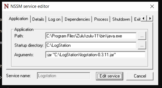

With LogStation being a JAVA app you need to use Java as the application and Logstation as the Arguments for the App.
Here’s a screenshot of what i’ve done.
I’m no expert but let me know if you have trouble and i will try to help but please read and understand what NSSM is before asking me.
