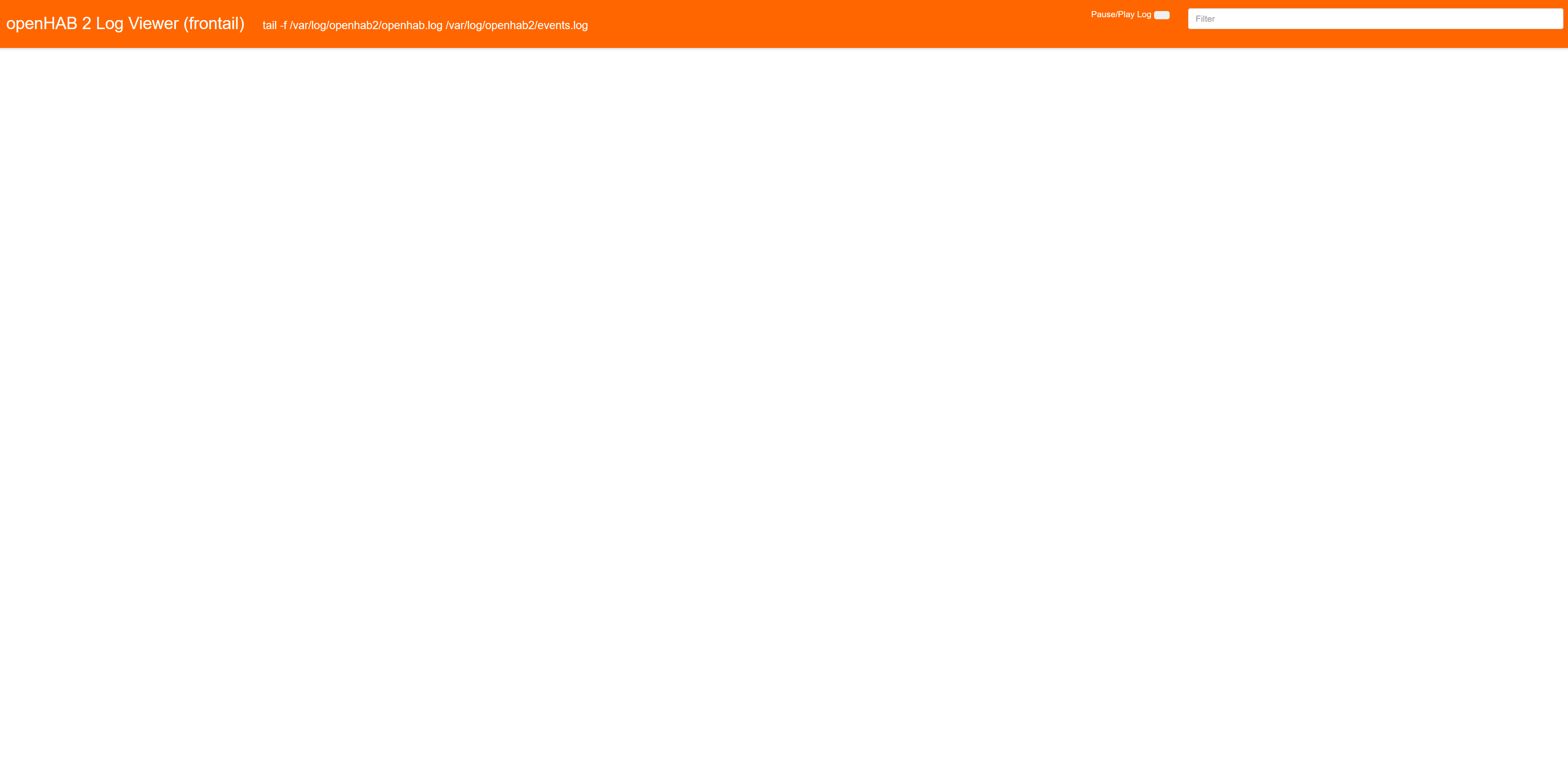

The weird part is, with this configuration in my Raspi 3, everything runs as is should. On the new Raspi however, frontail is not showing the log properly in the browser, it’s simply empty:
When I configure frontail without the url-path and host, I can access it through :9001, so the service itself is running correctly.
When I try to access it, my nginx shows the following error log:
2020/11/13 23:30:23 [error] 6005#6005: *9830 connect() failed (111: Connection refused) while connecting to upstream, client: 192.168.178.29, server: <my-openhab-server-address>, request: "GET /frontail/styles/openhab.css HTTP/1.1", upstream: "http://[::1]:9001/frontail/styles/openhab.css", host: "openhabiandevice.fritz.box", referrer: "http://openhabiandevice.fritz.box/frontail/"
