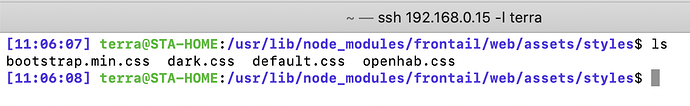

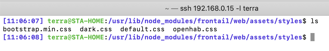

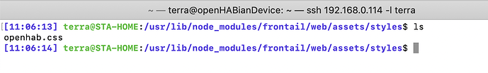

I saw that the bootstrap.min.css file is in the folder /usr/lib/node_modules/frontail/web/assets/styles on my old machine and I copied it over to the new machine and now the layout looks ok. However I also noticed that the new machine is also lacking the files “dark.css” and “default.css” in this folder.
old machine:
newly installed machine:
I am having the exact same problem - only openhab.css in the styles/ directory.

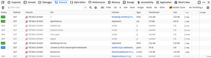

There are NO ERRORS in the web developer network view when it tries to load bootstrap.min.css. So I copied the url into another tab and it sure enough no error but redirects and loads frontail index, no error but not bootstrap.min.css. weird.

This deleted everything in /usr/lib/node_modules/frontail/web/assets/styles except for openhab.css.
I can put anything for this url like http://192.168.1.30:9001/styles/sillyme.css and it loads http://192.168.1.30:9001/ no error
Also notice how bootstrap.min.css is a type HTML and not CSS
