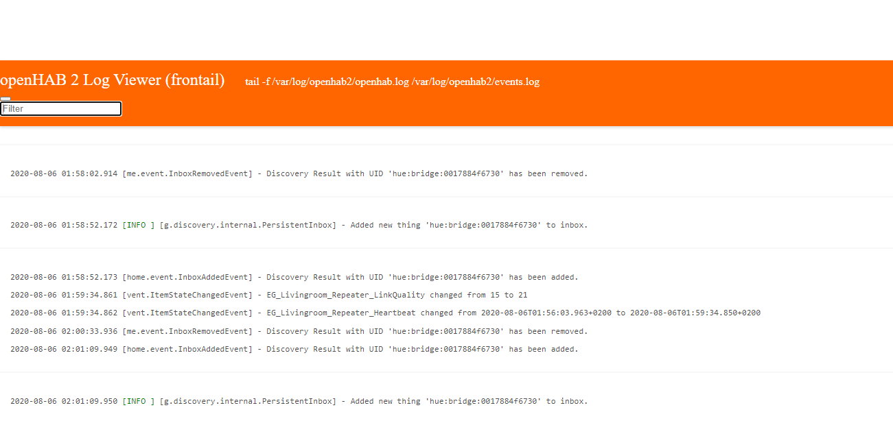

i use a Raspberry and new, a vm with ubuntu. Now, i want to change from the RPI to ubuntu and use openhabian.
But the frontail logviewer is broken by design.
openhabian on pi:
ubuntu on vm (top not fixed):
the code is different:
tail -f /var/log/openhab2/openhab.log /var/log/openhab2/events.log
<div class="container-fluid no-horiz-padding">
	<pre class="log"></pre>
</div>

For the second screen it looks like as the css (fortmatting) is broken. Looks very plain at least for the header. Could you open it in the brwoser and look at the debug section of it (–> of the brwoser, not OH) to see if any errors come up?

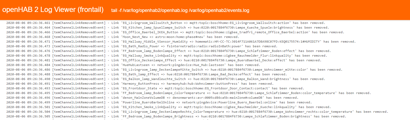

PI:
VM:

Ok, i have found the error.
Missing bootstrap.min.css. i have copied the file from the PI Installation and all was fine.

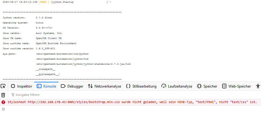

I have the same problem as you, but don’t understand how to solve. When I open the Browser (Debugger) I can see the following Error-Message:
I think there is also a bootstrap.min.css missing. But I don’t know where to get it and where to put it in.

if bootstrap.min.css would be missing you would get a 404 file not found error.
The message that is shown in your screenshot says that the wrong mime type is being send by the server.
Is your frontail instance “hidden” behind a nginx / reverse proxy ?
In that case you may have to check your nginx / reverse proxy configuration and make sure that the right mime type is being send for the file bootstrap.min.css ; may be even for other css files.

The browser says that it expects text/css ( correct for style sheets ) but it gets text/html.
