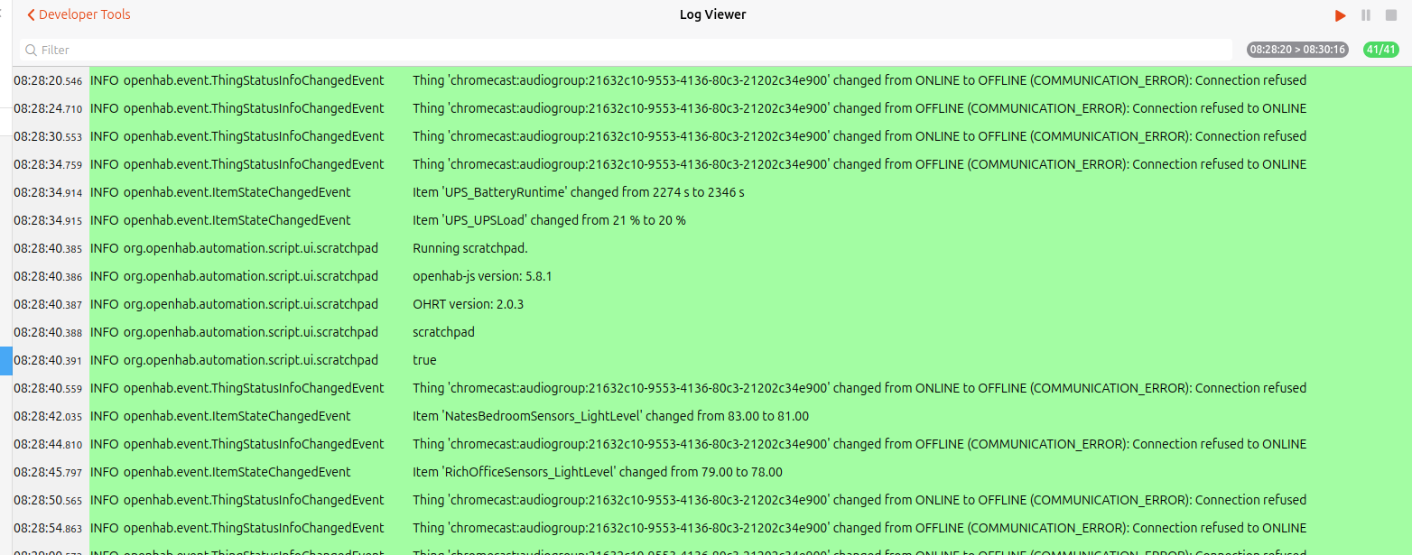

hmm, what is actually shown in the viewer then? What could the case that I don’t?
You can see it’s a mix of openhab.log and events.log.
It gets populated via a websocket. Maybe there’s something interfearing with that? I can’t say. I think it’s the case that it doesn’t work through myopenhab.org. Are you connecting locally?
