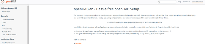

Its very confusing stating openHABian is not openHAB, when the document says:
Notice the title, “… openHAB setup”
Mind you, this is the doc for setting up openhabian hassle-free. Just as I did a few times.

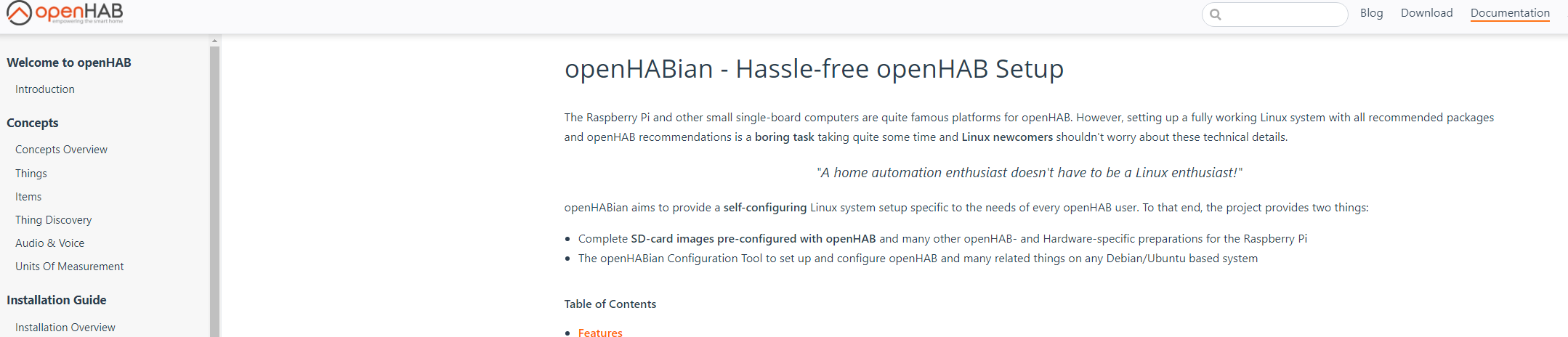

What part of
openHABian aims to provide a self-configuring Linux system setup specific to the needs of every openHAB user. To that end, the project provides two things:
  • Complete SD-card images pre-configured with openHAB and many other openHAB- and Hardware-specific preparations for the Raspberry Pi
  • The openHABian Configuration Tool to set up and configure openHAB and many related things on any Debian/Ubuntu based system
makes you think that openHABian == openHAB. It says it right there. It’s an SD card image with openHAB preconfigured and a configuration tool to set up and configure openHAB. “openHAB” is the object of both of those sentences. It’s the thing that openHABian is doing stuff to. “openHAB” is not the subject of the sentences.
