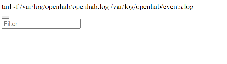

So I am trying to set up Frontail with Reverse Proxy with NGINX and it seems to half work. It shows something but not the whole thing.
I followed the recommendation from [SOLVED] How to config frontail log with nginx?
I also updated the config in /etc/systemd/system/frontail.service to (also change host ip to the IP of the Pi)
ExecStart=/usr/bin/frontail --url-path /frontail --host 127.0.0.1 --ui-highlight --ui-highlight-preset /usr/lib/node_modules/frontail/preset/openhab.json -t openhab -l 2000 -n 200 /var/log/openhab2/openhab.log /var/log/openhab2/events.log
I can reach http://192.168.2.10:9001 Just fine and shows all the graphics and everything.
Here is my config File: I have tried http://192.168.2.10:9001/;

If i try: http://localhost:9001/; in the above config
I get: 502 Bad Gateway:nginx/1.10.3

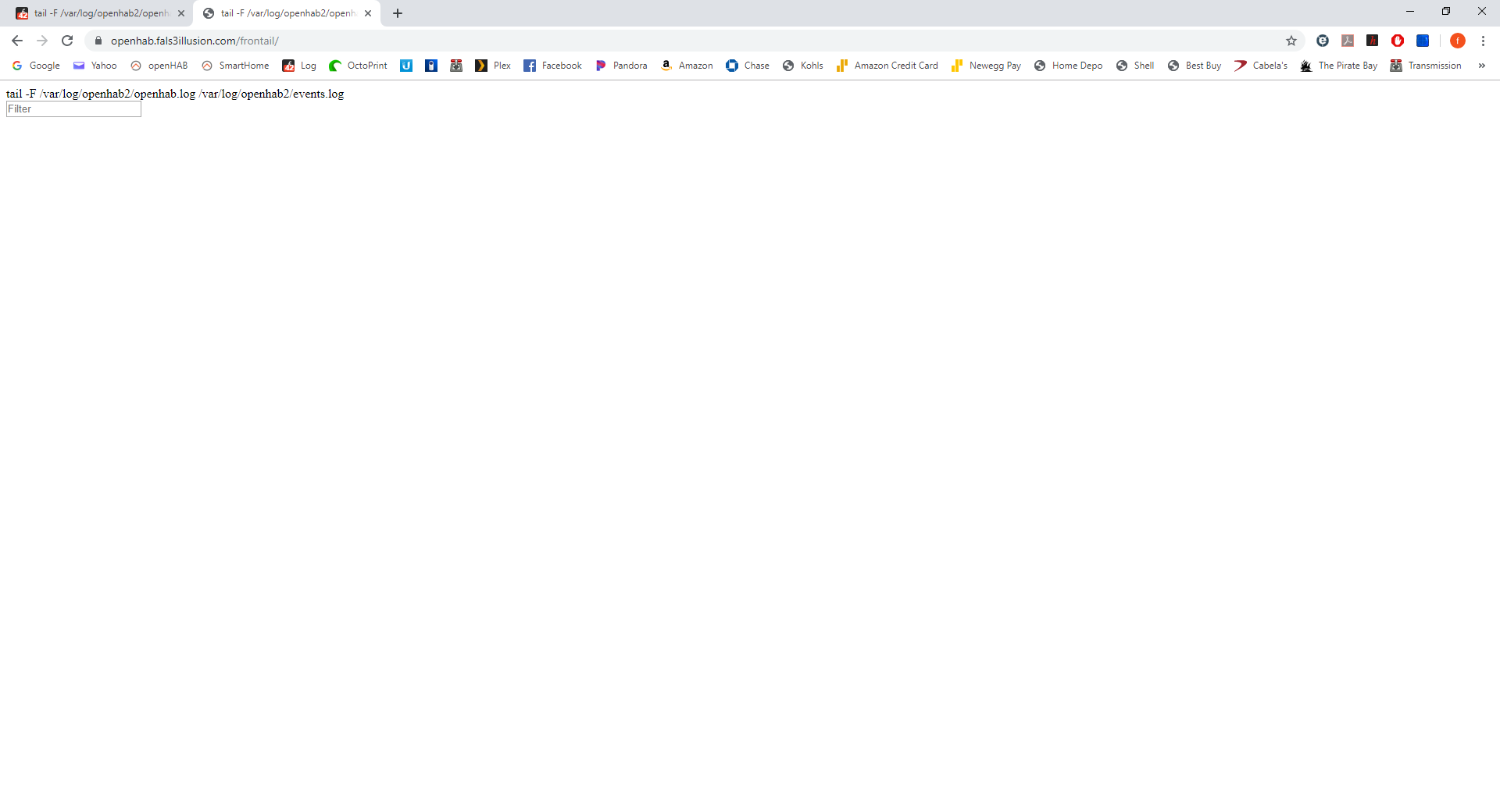

So I put the config back to the IP of the OpenHABianPi and I get the same thing from the picture above.
Any ideas for the half working Frontail?

Sofar with the above I get a /frontail log page with orange header, but not get NO logs are showing :frowning:
Under Network I get :
404 Bad request to wss://xxx/frontail/socket.io/?EIO=3&transport=websocket

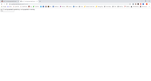

thx but with your config I only get this displayed on the web:
did you add --url-path /frontail to /etc/systemd/system/frontail.service ??
ExecStart=/usr/lib/node_modules/frontail/bin/frontail --url-path /frontail --ui-highlight --ui-highlight-preset /usr/lib/node_modules/frontail/preset/openhab_dark.json -t openhab_dark -l 2000 -n 200 /var/log/openhab/openhab.log /var/log/openhab/events.log
In /etc/systemd/system/frontail.service make sure that the Style sheet specified on the ExecStart line (the one after the ‘-t’) actually exists.
It should be present in the /usr/local/lib/node_modules/frontail/web/assets/styles directory. In Rar9’s example it would be a file named openhab_dark.css.
If it is missing, try to find it or change the config to point to default.css i.e. change -t option to default. I believe a default.css style is always present.
