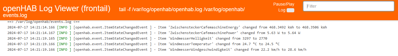

The openhabian version lookes like:
grafik

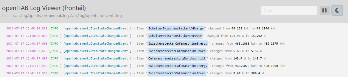

where mine (from the tutorial) produces:
grafik
Due to the worse formatting (blue highlighting of items…) it is a tad bit harder to read.
