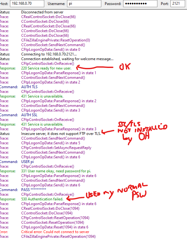

Basically I’m trying to implement the example in the ftpupload documentation for a camera trigger. After some back and forth with the Reolink camera technical support, it came to light their FTP output does not support TLS, but does support SSL 3.0. I verified this by ticking that box on my windows FTP set-up and the camera was able to connect and send images and video when motion was triggered. However, my OH 2.4 is on the Rpi3 and I have struggled to find the files that the ftpupload binding uses. Below is the log of a typical failed login attempt (many have been tried with different ID’s and passwords).
2019-09-02 17:50:15.116 [INFO ] [server.listener.nio.FtpLoggingFilter] - RECEIVED: USER openhab
2019-09-02 17:50:15.126 [DEBUG] [g.apache.ftpserver.command.impl.USER] - Currently 0 out of 10 anonymous users logged in
2019-09-02 17:50:15.130 [DEBUG] [g.apache.ftpserver.command.impl.USER] - Currently 0 out of 10 users logged in
2019-09-02 17:50:15.139 [INFO ] [server.listener.nio.FtpLoggingFilter] - SENT: 331 User name okay, need password for openhab.2019-09-02 17:50:15.144 [INFO ] [server.listener.nio.FtpLoggingFilter] - RECEIVED: PASS *****
2019-09-02 17:50:15.147 [DEBUG] [g.apache.ftpserver.command.impl.PASS] - Currently 0 out of 10 users logged in
2019-09-02 17:50:15.158 [WARN ] [g.apache.ftpserver.command.impl.PASS] - User failed to log in
2019-09-02 17:50:15.162 [DEBUG] [g.apache.ftpserver.command.impl.PASS] - Waiting for 500 milliseconds due to login failure
2019-09-02 17:50:15.665 [WARN ] [g.apache.ftpserver.command.impl.PASS] - Login failure - openhab
2019-09-02 17:50:15.673 [DEBUG] [g.apache.ftpserver.impl.FtpIoSession] - Statistics login decreased due to user logout
2019-09-02 17:50:15.676 [INFO ] [server.listener.nio.FtpLoggingFilter] - SENT: 530 Authentication > failed.2019-09-02 17:50:15.678 [INFO ] [server.listener.nio.FtpLoggingFilter] - CLOSED
2019-09-02 17:50:15.681 [DEBUG] [che.ftpserver.impl.DefaultFtpHandler] - Closing session
2019-09-02 17:50:15.692 [DEBUG] [che.ftpserver.impl.DefaultFtpHandler] - Statistics login and connection count decreased due to session close
2019-09-02 17:50:15.694 [DEBUG] [che.ftpserver.impl.DefaultFtpHandler] - Session closed
