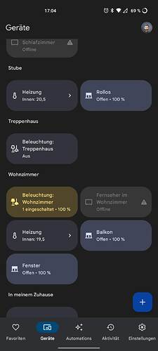

Here is my situation: I’ve got two rooms, each has shutters controlled with a Shelly 2.5 and Fritz!DECT 301 Thermostats. I managed to get each device fully working in google home.
But here’s the problem: If I tell GA to close all shutters in room 1, the shutters in both rooms get closed. Same if I ask for the actual temperature in one of the rooms, GA always tells me both temperatures.

As you can see in the first screenshot, the devices appear in different rooms.
In the second screenshot you see what GA answers if I for the temperature in the living room. (The temperature of both rooms Wohnzimmer and Stube are shown).
I tried now, what’s happening, if I speak in English to GA. Than everything works fine.
“What’s the temperature in the Wohnzimmer?” - “Die Temperatur wird auf 20° gestellt und es sind im Moment 19.5°”
Funny thing: I ask in English but GA still answers in German to me.
So I’m afraid it could really be a sth odd in the translation handling of German GA-inputs.

FYI: I renamed “Stube” for testing to “Küche” (kitchen). And everything is perfectly separated now.
Although there is no room called “Stube” in Google Home anymore, every command for “Stube” is still applied to the living room.
I think that proves, that my German commands get translated to English first. So synonymous room names don’t work with GA in other languages than English.
