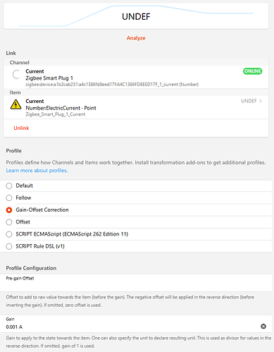

I’m trying to adjust current value dividing by a thousand. This is typically done by applying a gain factor of “0.001 A”, however I get UNDEF result instead
WARN	org.openhab.binding.modbus.internal.profiles.ModbusGainOffsetProfile	Profile can only process plain numbers from handler. Got unit A. Returning UNDEF
Testing with Offset it seems to work as expected:
I don’t know where else to look at on dealing this issue. I tried to mix and match multiple combinations of gain factor, measurement units, etc., but nothing seemed to help.

If the unit reported by the binding is incorrect, then ultimately this is a bug in the add-on and you should file an issue to have it fixed.
My understanding of the Gain/Offset profile is it expects the value from the Channel to not have a unit already. Modbus doesn’t supply one and the profile is a part of the modbus add-on.
So you’ll have to use a script transformation. Luckily this would be just a one liner. For JS it would be something like the following for the Thing to Item transform:
JS: | Quantity(Quantity(input).float/1000, "mA")
That parses and pulls the unit off of the value from the Channel, divides by 1000, then rebuilds the Quantity with the correct units.
