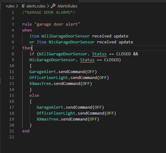

Hi @JimH i’m getting an error for “status”
Any idea of what is wrong?
i’m using visual studio code
VSCode is catching this. What does it say? Probably something like there is no status method. Replace status with state.

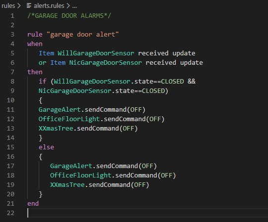

Remove the blanks and replace Status with State
like WillGarageDoorSensor.State
THe error message went away but the lights don’t come on.
Wondering if something to do with the brackets above garageAlert.
The sendCommands in the “else” should be sending an “ON” command instead of an “OFF” command. Once you save the Rules file you will need to open or close one of the garage doors so that one of the items receives an update (more on that later)

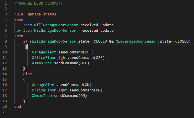

@JimH thanks for the help! Switching the OFF command with ON was the solution. See attached.
