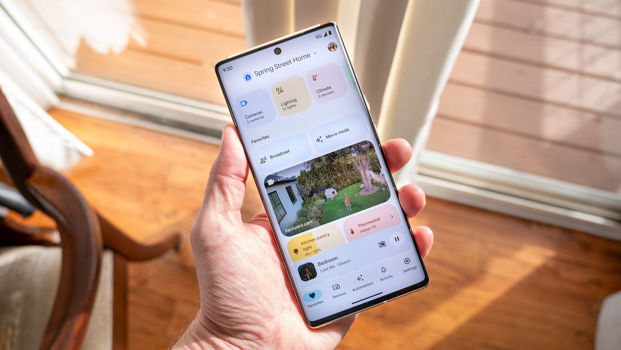

I think that Google didn’t really intend for the Home app to be a primary interace. Really, it’s there to configure devices/services/routines for Google Assistant. But they’ve caused some confusion by allowing some devices to work fully and limiting others. For example, door locks can be seen in the app, but you can only control them by voice. I would have expected the same for garage doors.
I imagine that it’s a typical Google “design by committee”, which has led to inconsistent implementations for different device types.
I previously said that you can just use a different device type, but really I just wouldn’t bother at all. Use the Google Assistant voice control as it is, and use the openHAB app when you need to press a button on your phone. Then you’re just using the Home app for configuration and not being frustrated when you run into its limitations. I only use the Home app to adjust my Nest devices.
I missed seeing that Google is rolling out a redesigned app, though I should have expected that with Matter launching. I’ll be curious to see how much individual device control improves (or doesn’t).
