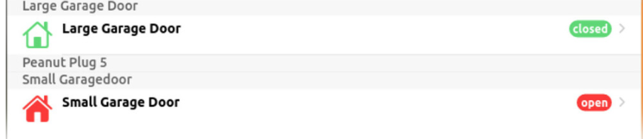

As rossko57 recommends, I use two Items, an actuator Switch Item which acts like a button so its state is kind of meaningless and a sensor Contact Item which represents the open/closed state of my garage door.
See Example Custom List Widgets for the List Widget that I use. It uses expressions to change the appearance and contents of the widget based on the state of the Contact. Clicking on the widget sends a command to the Switch Item to trigger the opener.
Note, in OH 3.2 you will be able to find and install this widget from the marketplace. For now you’ll have to copy and paste the YAML into a custom widget under Developer Tools.
I’ve used a similar approach for the main widget. I’ve two garage door openers and a camera (though the camera isn’t working right now) so I’ve combined all three into a unified widget.
Again, the color, icon and text changes based on the Contact Item and clicking on the widget sends a command to the Switch Item to trigger the opener. I know I’ve posted the code for this widget somewhere but can’t remember where so here it is.
