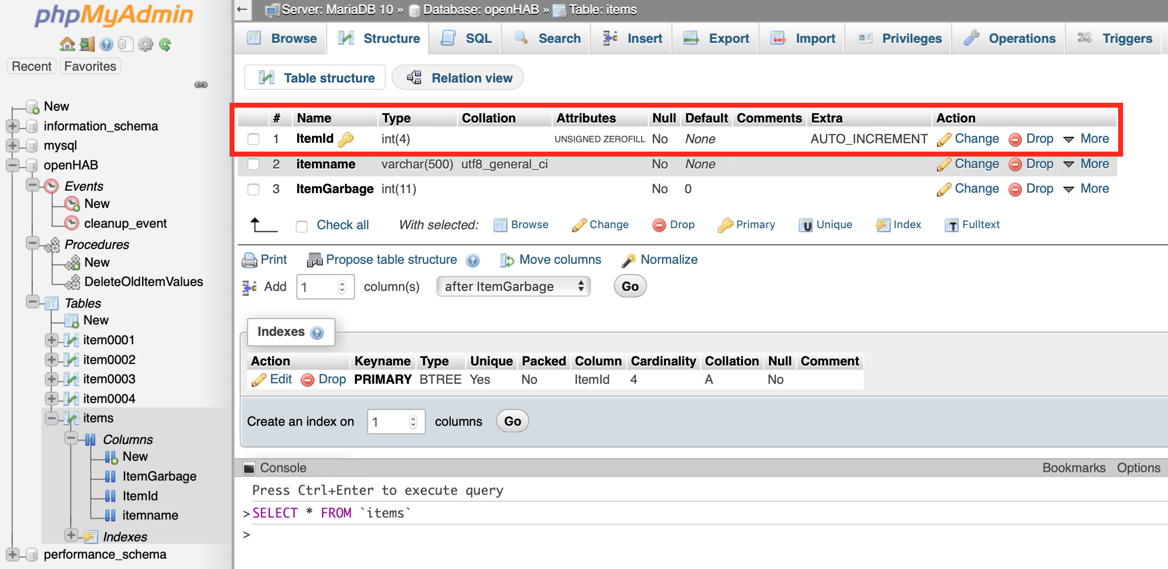

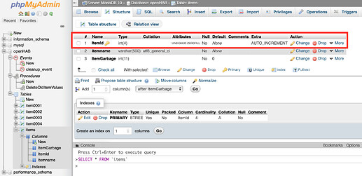

I few notes / comments which might help some other MySQL newbies like me.
My table is called Openhab2.items and not Openhab2.Items.
Furthermore, my item-tables are listed as item0001 in stead of item1.
I’ve changed the type into int(4) unsigned zerofill in the database. Now the itemID shows 0001.
I’ve done the same in your code; change
DECLARE var_tableId, var_done, var_garbage INT DEFAULT 0;
to
DECLARE var_tableId, var_done, var_garbage INT(4) zerofill DEFAULT 0;
and it all works.
That’s odd! I’m not aware of a change in the MySQL-persistence. Do you use the actual mysql one or do you use the jdbc-mysql?
I use the jdbc-mysql (combined with MariaDB on a Synology).
ok. it seems, the jdbc-mysql handles the tables differently! i use plan mysql.
Thanks for your help!

How should I change the script to use item-name as my tables in stead of item_suffix names?
More than a year later but I’m trying the procedure like you are mentioning but no rows are deleted. I edited one thing for testing purposes, instead of INTERVAL DAY, I made it INTERVAL MINUTE.
read_loop: LOOP
	FETCH myCursor INTO var_tableId, var_garbage;
    IF var_done THEN
      LEAVE read_loop;
    END IF;
	SET var_interval = concat(var_garbage, ' MINUTE');
I also edited this bit with the zerofill on your suggestion:
BEGIN
DECLARE var_table, var_interval VARCHAR(20);
The bit I don’t understand is this:
Furthermore, my item-tables are listed as item0001 in stead of item1 .
I changed something but I don’t know if it’s the correct change.
Can you or somebody else point me in the right direction? Thanks!
