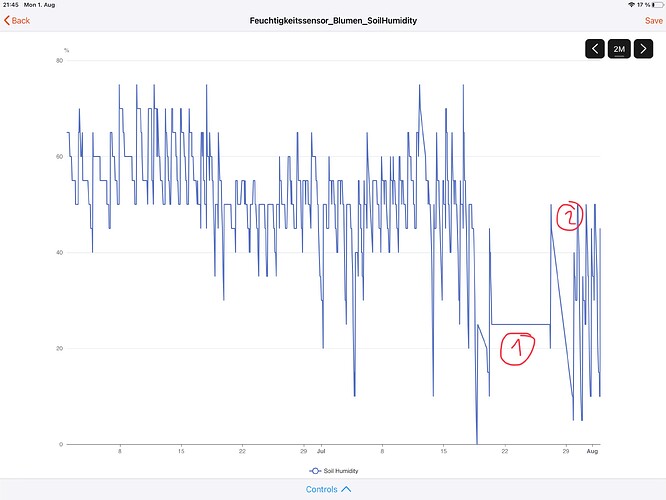

Getting worth since yesterday, now I‘m no longer able to disable/enable restart binding, nothing helps. Always Error 429 :-/

I just gave it another try late yesterday (about 11pm) and it worked. Surprisingly it’s still working, also this morning rule worked fine; was calling Gardena thing out of rule was breaking bridge before.
Not sure if Gardena changed something and not to call this solved, but at least bridge is still online on my end.

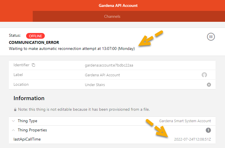

No. The act of opening a new websocket connection to listen for status changes is already sufficient to cause the error. (The server cancels the web socket every 120 minutes, so the binding has to open a new one every 120 minutes). It does not seem to make any difference what traffic is passing through the web socket.

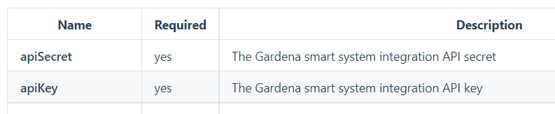

Which version of the binding are you using? There was a change at the server from logins based on email and password (in OH v3.3) to logins based on an api secret (in OH v3.4).
