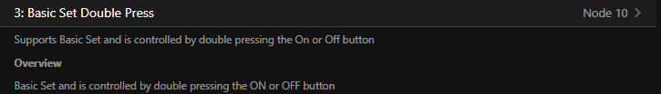

I have configured a 46203 Dimmer (which controls in ceiling can lights) with a double press to control a wall plug item that is connected to a lamp in the room.
It works perfectly. The issue I have is I do not see the double press reflected in the log, nor does the wall plug item update to correct status. Is this correct behavior, and is there anything that can be configured to correct this?

Yes, event log. In experimenting I used the Scene channel of the dimmer to control the wall plug, and that seems to update the status with double press when turning on, but not when turned off.
