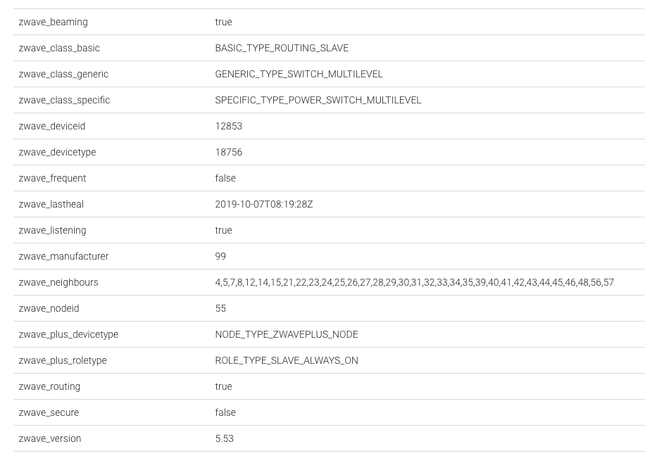

I recently picked up 2 GE/Jasco Z-Wave switches (https://byjasco.com/products/ge-enbrighten-z-wave-plus-wall-smart-dimmer-quickfit-and-simplewire). When I added them to my Z-Wave network, OH gave me a message that the device is not in the database. I’m pretty new here and am not sure if this is where I raise the issue or somewhere else. If someone could let me know that would be great. Attached is the properties of the device (the manufacturer is set to 99 which is the same as my other GE/Jasco switches).

What version of OpenHAB? You may need to update your zwave binding.
The device is in our database here.
openHAB 2.4.0-1
That may be too old. This scrip can update the binding for you.
You should then delete the Thing from OpenHAB & re-discover it.

I ended up upgrading to 2.5M3 (I didn’t recognize that as an option on the download page). Once I updated to 2.5M3 the devices both came up properly. I didn’t have to re-add them, I tested them and they work just fine. Thanks for the help.
