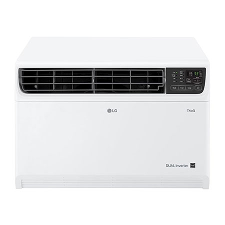

I’m developing the binding for LG API Smart Thinq and it’s very stable. The support for A/C is ready to control target temperature,operation mode, some special functions and fan speed. You can follow it at the topic https://community.openhab.org/t/contribution-lg-thinq-binding
No kidding? Well that is even better news since LG is my go to brand!
I’ll read through your thread but basically what you are saying is yourn binding would support this:
Is that correct?
Yes, dude. Since your device supports LG Thinq integration, you are able to use LG Thinq binding.
But, i’ve never tried integrate with this window model. It has a really good chance to works out of the box, but if need some changes to works, i can do it.

Sorry for the delayed response @nemer . I pretty sure I’ll end up with that or another LG model so I will post how that goes. I’m not a fan of using IFTTT so GE would be a hard pass (for now?)
I take it this is the link…
https://github.com/nemerdaud/openhab-addons/blob/feature/lgthinq-binding/org.openhab.binding.lgthinq-3.3.0-SNAPSHOT.jar
…and this file gets dropped into /var/lib/openhab/tmp/kar/openhab-addons-3.2.0/org/openhab/addons/bundles (as an example) ?
No, normally is on: /srv/openhab-addons or /usr/share/openhab/addons (they point to the same inode).
When you put there, automatically openhab will install it.
