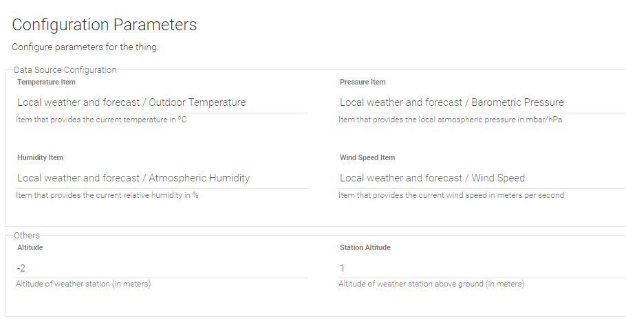

Hi, Thank you for the binding, I’m having some trouble getting values in the items.
Here is the Thing config in PaperUI:
These channels are also linked to items, and they have a value.

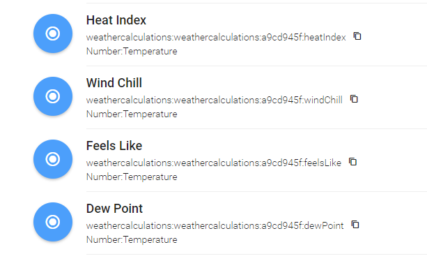

Here are the channels:

The thing isn’t configured.
You need to fill in the Data source fields to tell the binding which items it should get the information from

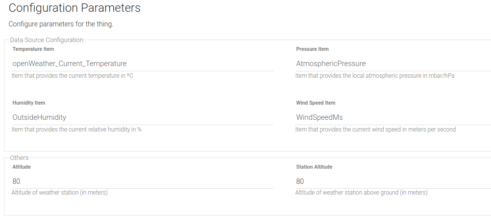

This is mine:
But there is a dropdown t choose from known channels? I did that.
I really thougt that was the way to configure
I now pasted in my own Items names, now Dewpoint is filled in. Probably the rest will follow.
thanks for the help.
Yes, that’s changed… The binding needs items in there not channels…

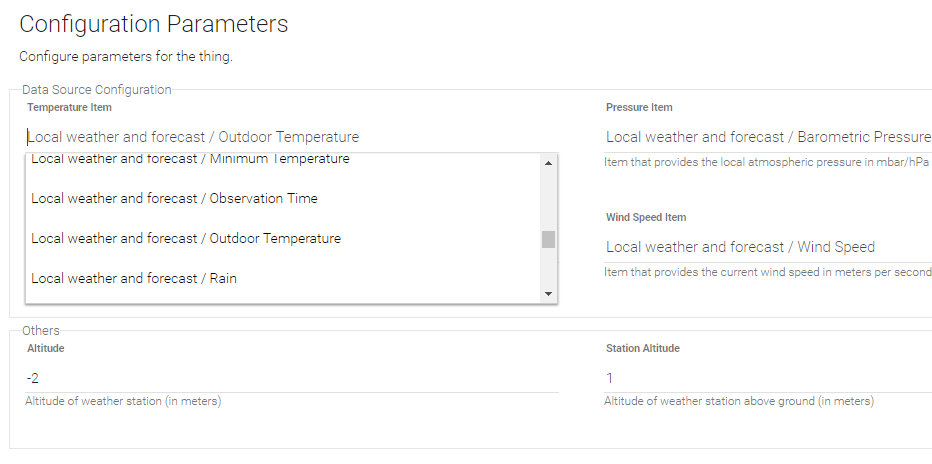

@hww3, this is odd behaviour, the drop down should show a list of items, instead it’s listing ALL available channels, even the ones I don’t have items linked too!!
The approach I used to populate the dropdown works well for managed items but not so well for items that you define yourself (such as in an items file). The pick list widget does allow entries to be typed manually.
I’ve looked at populating the pick list directly from the item registry, but then it’s not possible to know how items may be related to things, and the list gets very confusing quickly… when testing, I had 5 items all named Temperature; which one is the temperature reported by my weather station?!?
The whole point of providing a picklist is to make configuration easier, and that’s obviously not what’s happened for some folks, so I will spend some time looking into alternative approaches.
