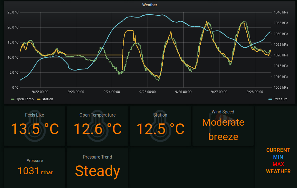

I have been watching this for a while now and the pressure trend does change:
