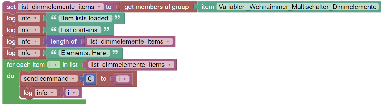

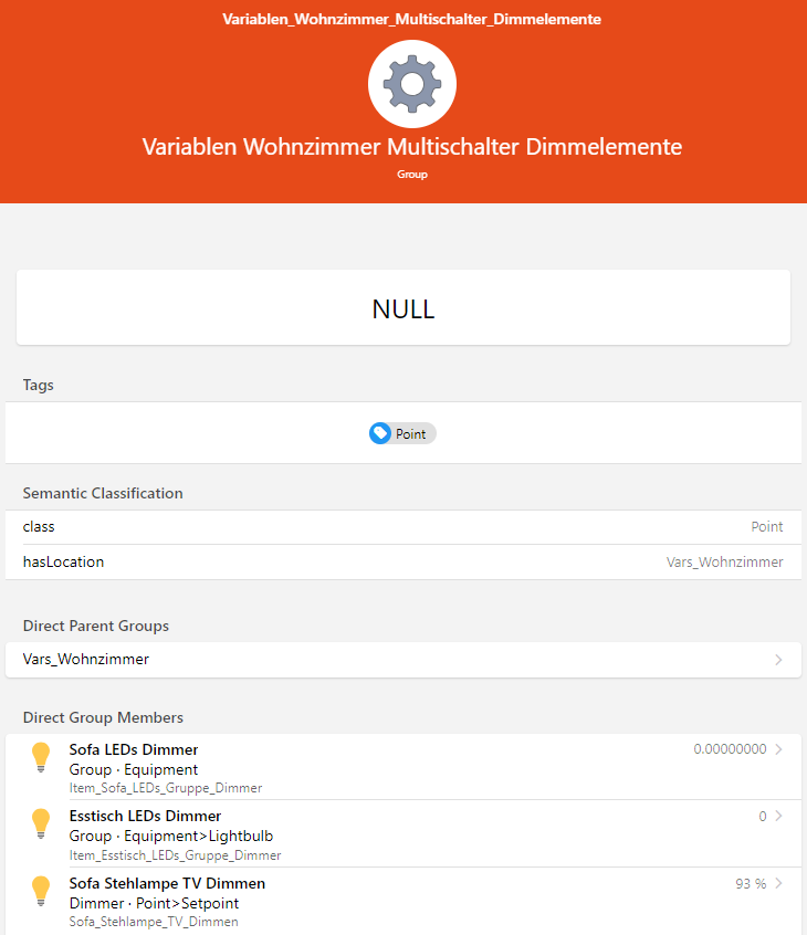

i added 3 dimmer group items to another group item as follows:
In a blockly rule i now select items from the group item by its index as follows:
  1. Create a variable to store the list of items:
    (In the log i plot the items via a for loop and the output is as expected:
  2. I now have a variable “index” that holds the index of the item in the list that i want to control (index is within 1 and the length of the list of items (for shure)) and i try to get the item in the following line:

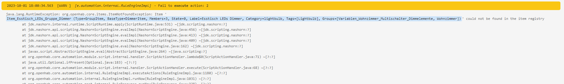

And this causes the following error, saying that the requested element is not found in the item registry (never heard about that):
To make the story completely weird, if i try to set the items values via a for loop, the items can be accesed and states change as expected:

@Oliver2 nailed the root problem right on the head. The error is sendCommand is expecting the name of an Item and you are passing it the whole Item Object.
