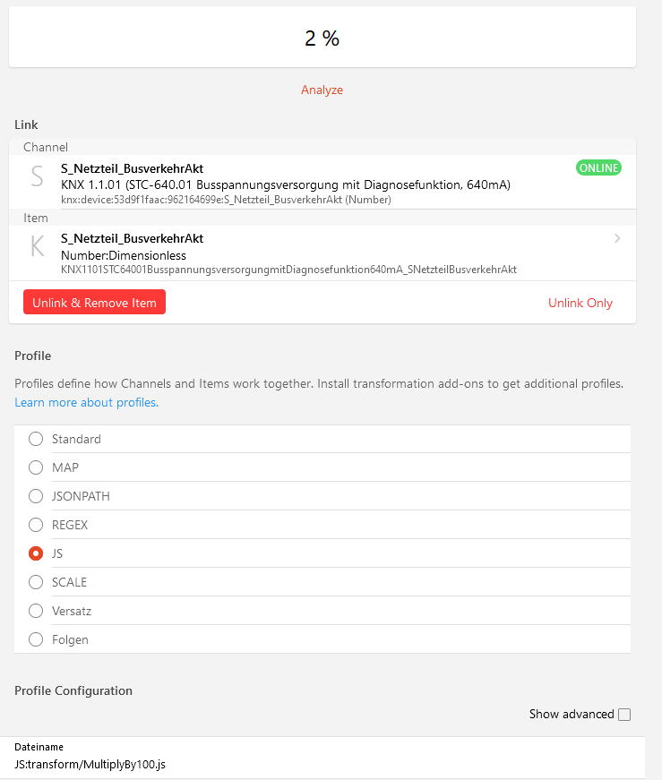

  1. Added an item
  2. But how to convince the item to show the percentage value correctly?
I tried Pattern "%s %%". It shows “4 %”, but with an error message
Could not transform state '4' with function 'JS:transform/MultiplyBy100.js' and format '%s'.

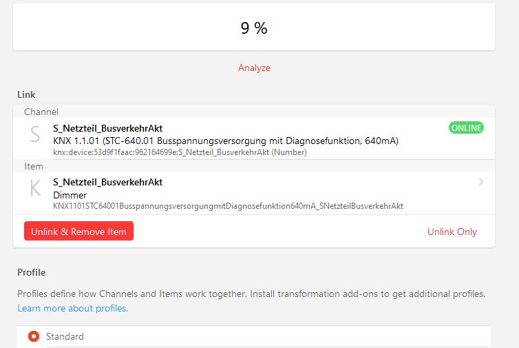

why not use a dimmer ?
The output of the javascript that you are using in your transform profile is numeric only.
If you want that to be a percentage in your Number:Dimensionless type Item, you’ll need to append the units string " %" to your javascript result before returning it.

Adding the item type to dimmer → error message is gone. Thx.

  • Item state description
  • In the item overview, the percent is not shown, but in the details (see below)
