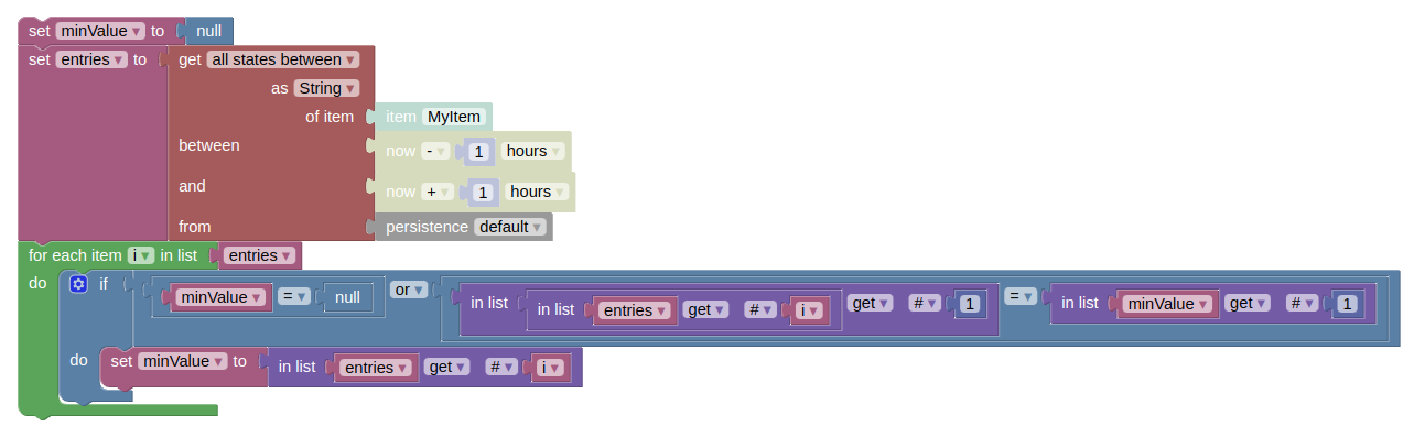

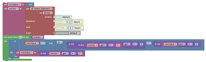

Actually, it’s not a String. It’s an array of two element arrays (first element is the timestamp, second is the value). You’ll need to use a loop and variables to loop through the array to find the minimum value and tiemstamp for that Item.
It will look something like this:

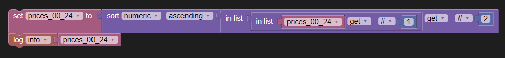

And how do I sort this array on the 2nd element?
I tried something like this, but now I’m trying to sort only the first item of the array.
This might not be easy to do through Blockly because it is an array of key/value pairs. You might need to use the script block.
