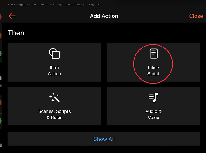

This would require creating a script in the rule that can be created when you click add action
You will need to pick the language you want to use (all except DSL which is more legacy) are good choices with the first Blockly being a good choice for beginners and for those not familiar with coding or the other languages because it provides a drag and drop approach. Rules Blockly | openHAB
blockly is also a good choice because it will allow you to see the code that it has generated
To use Blockly you will also need to have the Javascript addon installed in openHAB JavaScript Scripting - Automation | openHAB

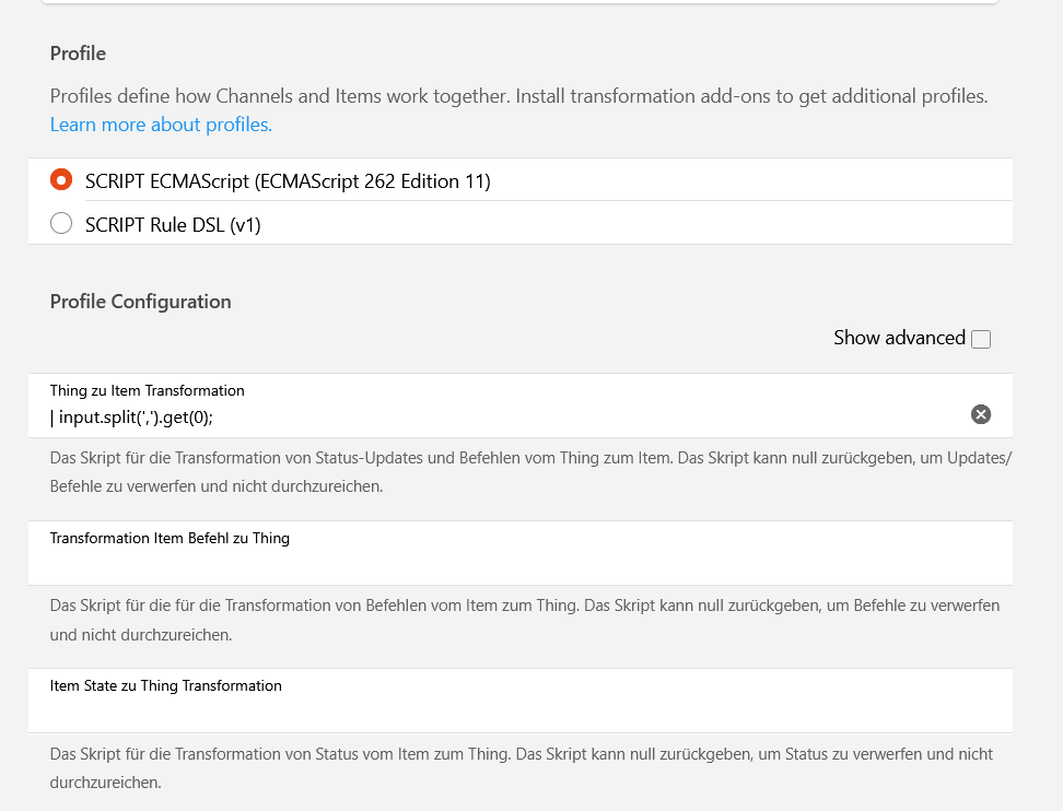

You can already do the splitting with a transformation in the profile (between item and channel). If you have to change “SCRIPT Rule DSL (v1)” to “Thing to Item Transformation”
| input.split(',').get(0);

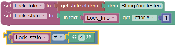

I’ll chime in here since I’m a Blockly user myself.
For the “But only if” condition to work, you need a Logic block. It seems there are still issues with using “return”.
I’d like to advocate for the transformation here again. If you create an additional Item of type NUMBER in the channel using “Add Link to Item…” and “Create a new Item”, you only need to select the Parent Groups and Script. One advantage of Number is persistence.
Theoretically, you should be able to do everything with just one rule, but I advise against it. With that volume of tasks, it quickly gets cluttered in Blockly. Break it down into individual tasks and use functions, scripts, or rules for each. For example, one rule triggered by the Nuki that arms/disarms the alarm system, saves the contacts when leaving, and outputs a message for any that are already open. Another rule triggered by the Contacts group reacts when the alarm system is armed, and so on…
If you create multiple Blockly scripts for a single rule, you can give them a title and description within the script. To do this, click on ⌃ in the bottom right corner.

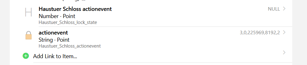

I’ve created an Item of type number by using link to Item (Actionevent) and named it Haustuer_Schloss_lock_state, selected the parent group and chose script ECMA…
At the thing to item transformation I’ve put in your code of your first post. I think I did something wrong, because the result is NULL.
Here some screenshots:
The solution above was for DSL because I didn’t know which language they prefer. In JS should
| input.split(‘,’)[0];
go.
Thanks for your fast answer, but the result is unfortunately the same.
I’m not sure if I have chosen the right transformation.
Sorry I really have not so much experience with openhab.
