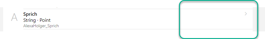

I installed the amazonechocontrol-binding, connected the account and added an echo speaker. There seem to be two things for the same physical object. One of them (the smarthomedevice, probably the one I need?) doesn’t connect correctly:
So I use the other device which has a lot of channels for music control, but also some for commands which should make her speak: Sprich/textTo Speech and Befehl/textCommand:

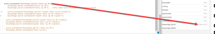

I created items for all channels, then tried a bunch of javascript-lines in a rule, none of them make her speak:
events.postUpdate("AlexaHolger_Sprich","Alexa say OK");
AlexaHolger_Befehl.sendCommand("Alexa say OK");
AlexaHolger_Sprich.sendCommand("Alexa say OK"); //this seems to be the German texttospeach-channel
events.postUpdate("AlexaHolger_Sprich","<speak> Alexa say OK </speak>");
AlexaHolger_Befehl.sendCommand("<speak> Alexa say OK </speak>");
AlexaHolger_Sprich.sendCommand("<speak> Alexa say OK </speak>");
events.postUpdate("AlexaHolger_Sprich",<speak> Alexa say OK </speak>);
AlexaHolger_Befehl.sendCommand(<speak> Alexa say OK </speak>);
AlexaHolger_Sprich.sendCommand(<speak> Alexa say OK </speak>);
events.postUpdate('AlexaHolger_Sprich','Alexa say OK');
AlexaHolger_Befehl.sendCommand('Alexa say OK');
“AlexaHolger_Befehl.sendCommand is used for routines.” ← so I guess only the “events.postUpdate”-commands work. When I run that, the text gets inserted into the item but Alexa remains silent (no matter whether with or without):
