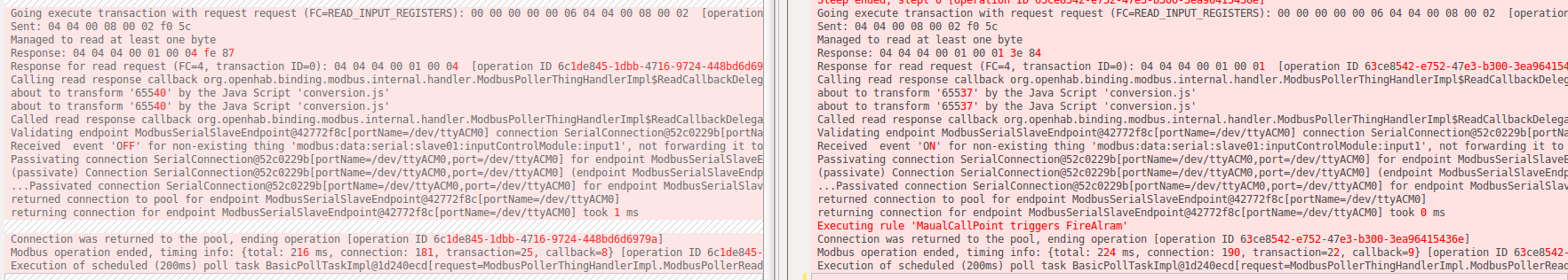

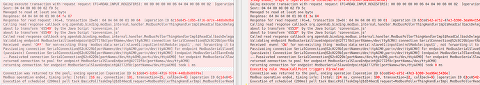

Hi Rossko,
I am getting this issue sporadically,
2019-04-09 15:20:51.248 [DEBUG] [ntime.internal.engine.RuleEngineImpl] - Executing rule 'MaualCallPoint triggers FireAlram'
2019-04-09 15:20:51.248 [DEBUG] [rt.modbus.internal.ModbusManagerImpl] - Modbus operation ended, timing info: {total: 220 ms, connection: 187, transaction=24, callback=9} [operation ID 363261ae-40dd-476e-b82c-a08ca93ff620]
2019-04-09 15:20:51.248 [DEBUG] [rt.modbus.internal.ModbusManagerImpl] - Execution of scheduled (200ms) poll task BasicPollTaskImpl@18fefb30[request=ModbusPollerThingHandlerImpl.ModbusPollerReadRequest@6d91bb9a[slaveId=4,functionCode=READ_INPUT_REGISTERS,start=8,length=2,maxTries=3],endpoint=ModbusSerialSlaveEndpoint@6cebdc44[portName=/dev/ttyACM0],callback=org.openhab.binding.modbus.internal.handler.ModbusPollerThingHandlerImpl$ReadCallbackDelegator@818e012] finished at 1554803451248. Was started at millis: 1554803451028 (=duration of 220 millis)
2019-04-09 15:20:51.250 [ERROR] [ntime.internal.engine.RuleEngineImpl] - Rule 'MaualCallPoint triggers FireAlram': An error occurred during the script execution: Could not invoke method: org.eclipse.smarthome.model.script.actions.LogAction.logDebug(java.lang.String,java.lang.String,java.lang.Object[]) on instance: null
2019-04-09 15:20:51.278 [DEBUG] [rt.modbus.internal.ModbusManagerImpl] - Executing scheduled (100ms) poll task BasicPollTaskImpl@1a03f7c1[request=ModbusPollerThingHandlerImpl.ModbusPollerReadRequest@20c3714
When Manual Call point event occurs, Alarm is not called because of this.
I am waiting for the input.
Is it because of HW or configuration ?
I think that’s a dumb idea. At periodic intervals, you reset the detector if it is set. Why? Your other rules may still be processing a sensor event, or may not even have started processing it yet.
Do you think it might be better to start off a timer when you see a sensor set, that will reset it some fixed time later?
The logDebug in you rule failed because something was null. Cannot see any reason for that in the version of the rule you have shown us. Make sure you do not have two rules with the same name rule "MaualCallPoint triggers FireAlram"
