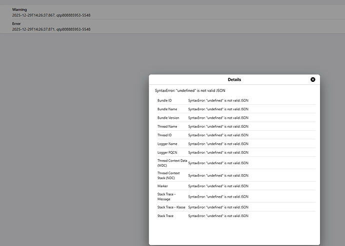

Unfortunately, I can’t get the pop-up to work; I have no idea where the problem lies.
My vLog item looks like this
[{"timestamp":"2025-12-29T14:26:37.867","level":"WARN","message":"Warning","threadName":"qtp808885953-5548","threadId":5548,"loggerName":"org.openhab.automation.jsscripting.rule.1a9bd9e8c4","loggerFQCN":"org.ops4j.pax.logging.slf4j.Slf4jLogger","bundle.id":"290","bundle.name":"org.graalvm.truffle.truffle-api","bundle.version":"25.0.1"},{"timestamp":"2025-12-29T14:26:37.871","level":"ERROR","message":"Error","threadName":"qtp808885953-5548","threadId":5548,"loggerName":"org.openhab.automation.jsscripting.rule.1a9bd9e8c4","loggerFQCN":"org.ops4j.pax.logging.slf4j.Slf4jLogger","bundle.id":"290","bundle.name":"org.graalvm.truffle.truffle-api","bundle.version":"25.0.1"}]
Your json object looks fine - otherwise you would see the same type of error in the overview widget.

That’s weird. I couldn’t get it to work, too.
The problem is that variable logDetails stays undefined when clicking on an oh-list-item
action: variable
actionVariable: logDetails
actionVariableValue: =JSON.stringify(loop.rLog_source[loop.rLog_idx])
I assume the structure of your page (oh-list-card → f7-list) is somehow colliding.

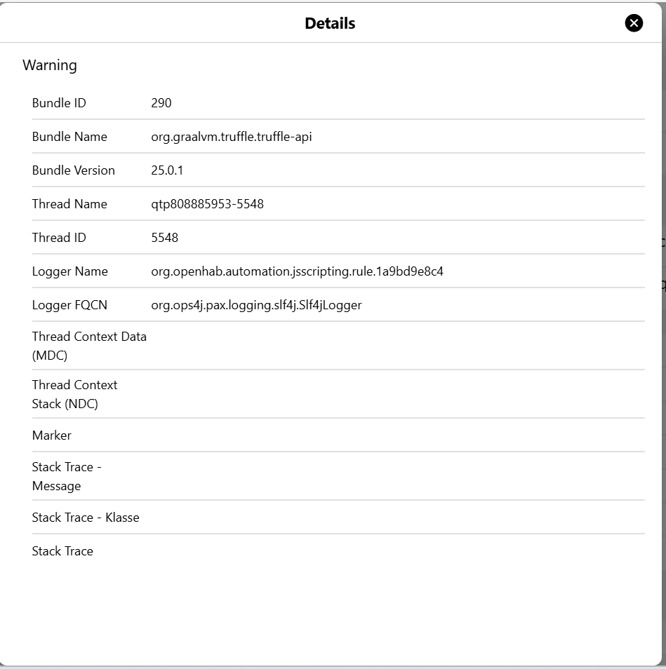

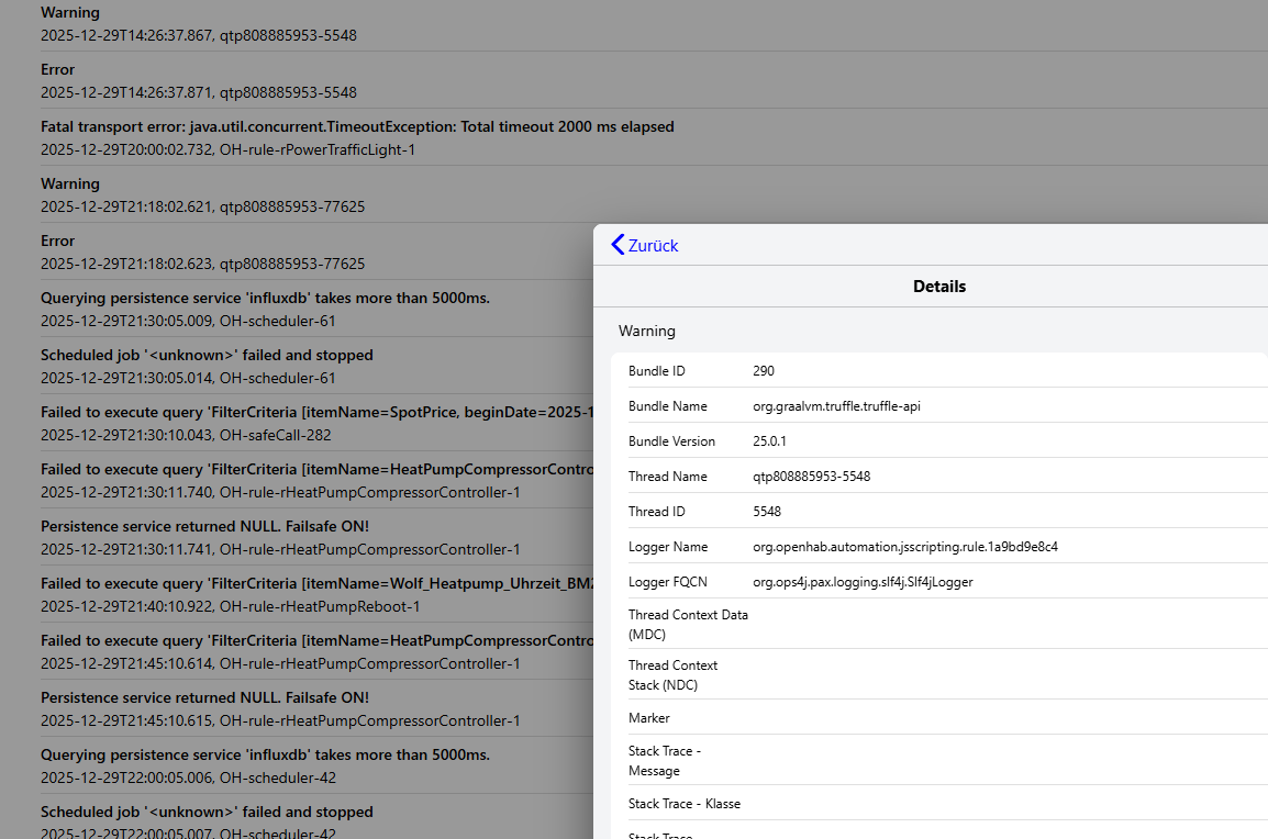

@Oliver2 I made a few changes and now it works for me too. The changes are on the page (action popup) and in the popup widget I work with parameters that are transferred when called. I think the problem has something to do with the JSON data transfer.
Is it possible to add a return after each entry in the critical.log so that the file is easier to read?

Yes, it is possible. Simply delete this attribute eventDelimiter="," from log4j2.xml.
But this means that you need to adjust your import script. that script will become more complex as JSON.parse() will not be working anymore.
Just a few notes as this line inside the repeater might have mislead you
for: vLog
This is a variable inside the repeater, it is not an item nor a string containing log details.
You can remove itemLog from actionModalConfig: and from props: parameters from your popup
Minor change: props: parameters logDetails is not of context item. But it works anyway as MainUI seems to be ignoring it.
There’s no popup when I click an entry… But maybe I put these components in another component which impedes the pop-up?
Would you mind sharing the complete yaml of your page?
@Oliver2 Thanks for the tips. I have edited my post.
