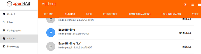

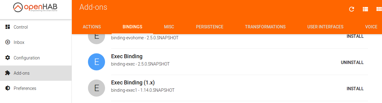

i am trying desperately to light a LED with my Raspberry3 running openhab2.
I have a Thing:
Thing exec:command:ledein “LED ein” [ command="sudo sh /etc/openhab2/scripts/ledein.sh %2$ ]
I have an Item:
Switch ledein “LED” { channel=“exec:command:ledein:run”}
an a sitemap:
Switch item=ledein mappings=[ “ON”=“Ein”, “OFF”=“Aus” ]
I don´t have a LED giving light.
I´m shure its pretty easy,
but sorry , I’m german
EDIT led goes on by running the command line from the thing
