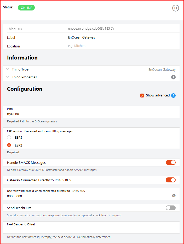

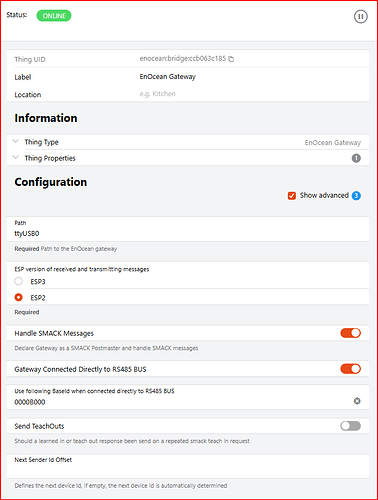

And now:
This appears to only work if I run feature:install openhab-misc-serial-purejavacomm after every openHAB restart:

Ok, but to the “important part”: Does it change the “malformed packets”?
Sadly, no…
