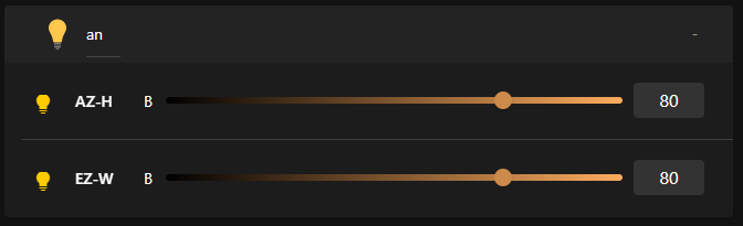

I’m quite happy with the current solution:
  • the repeater-function works fine and is really helpful when I’ll add the other lamps
  • the lightbulb symbol acts as a switch
  • when clicking on a name like “EZ-W” a widget I created to change colors pops up
  • in the first row it tells me the number of total lights on. I did this in node-red since I don’t know how to do that in OH (or if it’s possible at all). One would probably need some kind of global variables and I wouldn’t know where to enter the (javascript?) code anyway (rule, script, how to connect it efficiently). If there are significant advantages of programming such things in OH, I’d be interested in a link to a rather simple introduction. But for now, things are fine.
  • Next I’ll add a button to switch off all lights; I guess I might use OH-rules for that but that shouldn’t be too difficult.
The one thing I still don’t get well is the alignment:
  • the vertical alignment is poor; I’d like it to be centered. At the moment the text is higher than the slider.
  • I don’t really understand how to best define the column widths. Should I use fixed pixels (e.g. 20px) for items with fixed lengths (the lightbulb symbol, the names which won’t be more than 4 letters). If so, what to do with the slider which I’d like to be as wide as there is room left? Or just give a % to each column so that their values add up to 100%. And I’m not sure if padding disrupts that and if so, how to best deal with it.
If you have ideas how to further improve the look and functionality, let me know. After all, it’s Corona-time so I have enough time at my hands to play around with OH :wink:
Anyway, here’s the code

You can set your column to 100% height and use flexbox to assign align-items: center which would vertically center your components inside. There are tons of possibilites with flexbox (or grid) layouts which you can use for your custom-widgets.
You could use width: fit-content on your first column for example to make it just as wide as the content. Set the other column to width: 100% would make it fill all the remaining space. Adding flex-wrap: nowrap to the outer row, would prevent the elements from breaking over multiple lines.
It might be worth investing some of that time into diggint into CSS. :slight_smile:
Especially the mechanics of flexbox- and / or grid-layout are very usefull for the creation of custom-widgets.
… or try this (which looks very funny tbh)
Two other things:
  • It’ s usefull to use the rawest available variant of custom components, if they are available. oh-colorpicker-card for example is, like the name says, a colorpicker with a card around it - so a lot of ‘unnecessary’ styles (at least for the use in a custom widget) are already applied.
    It would be easier to align your contents if you use oh-colorpicker.
  • You don’t need a third column in your widget, as you want the icon and the text next to each other. Just put the two elements into one column and assign the flex-direction-row class to it.
Here a quick code example:

Thanks for your quick help (again :slight_smile: ) I’ll implement that tonight …
Now I’ve looked a bit at the flex and grid- info you recommend. The commands seem plausible but I’m not sure where to put them.
Let’s say I want to have the lightbulb-button to the left, right next to it the number of active lights right next to it and to the very right a button to switch all lights off.
First, I added a row with two columns (mostly by copying your example in the first line and then adjusting the content). In the first column I put lightbulb and number in the second column the button. That’s ok so far.
But now I need to tell the button in the second column to be aligned to the right. I guess the command “justify-content: flex-end” might be the correct one but I don’t know where to put it. Something like
“style: justify-content: flex-end” in line 63/64 doesn’t work. Wrong command, wrong position, not in “style” but elsewhere? …

                                        - component: oh-button
                                            action: command
                                            actionItem: =loop.devices.actionitem
                                            actionCommand: '=(items[loop.devices.actionitem].state.split(",")[2] === "0") ?
                                              items[loop.devices.actionitem].state.split(",")[0]+
                                              items[loop.devices.actionitem].state.split(",")[1]
                                              + ",80" :
                                              + ",0"'
                                            icon-f7: lightbulb_fill
                                            iconColor: '=(items[loop.devices.actionitem].state.split(",")[2] === "0") ?
                                              "gray" : "yellow"'
                                            style:
                                              --f7-button-bg-color: transparent
                                              --f7-button-hover-bg-color: transparent
                                              --f7-button-pressed-bg-color: transparent
                                            action: popup
                                            actionModal: widget:Widget_farben
                                            actionModalConfig:
                                              leuchte: =loop.devices.actionitem
                                            text: =loop.devices.label
                                            color: blue
                                            style:
                                  - component: f7-col
                                      class:
                                        - display-flex
                                        - align-items-center
                                      style:
                                        height: 100%
                                        width: 100%
                                      default:
                                        - component: oh-colorpicker
                                            sliderLabel: true
                                            sliderValue: true
                                            item: =loop.devices.actionitem
                                            modules:
                                              - brightness-slider
Exactly!

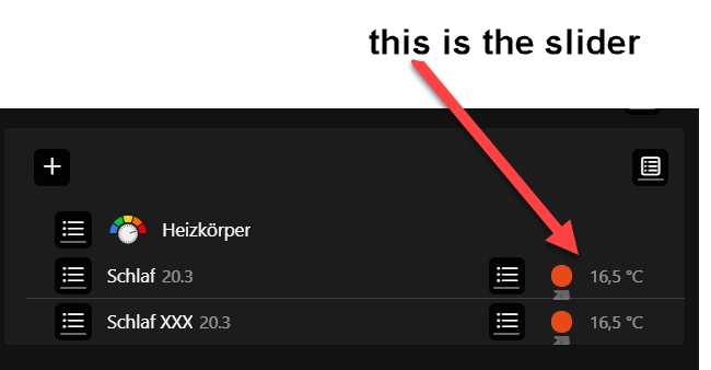

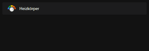

Here I’am again :wink:
With your help I got things working fine. Now I’m trying to do a very similar thing; this time heater control: label - current temperature - slider for target temperature (which should get the most space).
I’ve done a row with two columns (second column for the slider; including “- justify-content-flex-end”) so it should work fine. But here’s what I get:
For testing purposes, I inserted the slider-defintion in the working lights-solution from above be replacing the colorpicker/brightness slider. And then it’s not working there either. So it seems to be the slider definition. But the slider-code inside a simple list-item works fine. So I have no explanation …
The slider is in the end of this code

Right now I’d think it’s an OH-bug but it’s more likely that I just don’t see my mistake :wink:
I’d like to remind you of this quote from our discussion here
There are indeed usefull scenarios where it makes sense to use other components, but these should be wisely thought out exceptions.
I’d recommend you, using already existing components wherever it’s possible, as they saves you a lot of trouble and time.
It will unnecessarly mess up your code and leads to unwanted behaviours if you try to customize things wheres no need for it.
It would be too complex, getting into the details of css here. If you’re willing to invest some time, I’d recommend you digging a bit deeper into this topic with courses or similar. You’ll find plenty of ressources for that online.
The same thing is valid for the oh-slider-item component - use oh-slider in your custom-widgets.
There are 2 solutions which I’d recommend (and there might be even more or better solutions which I don’t think of)
  1. Using just basic oh- components (recommended)…
