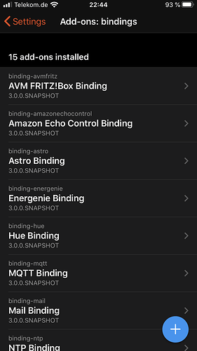

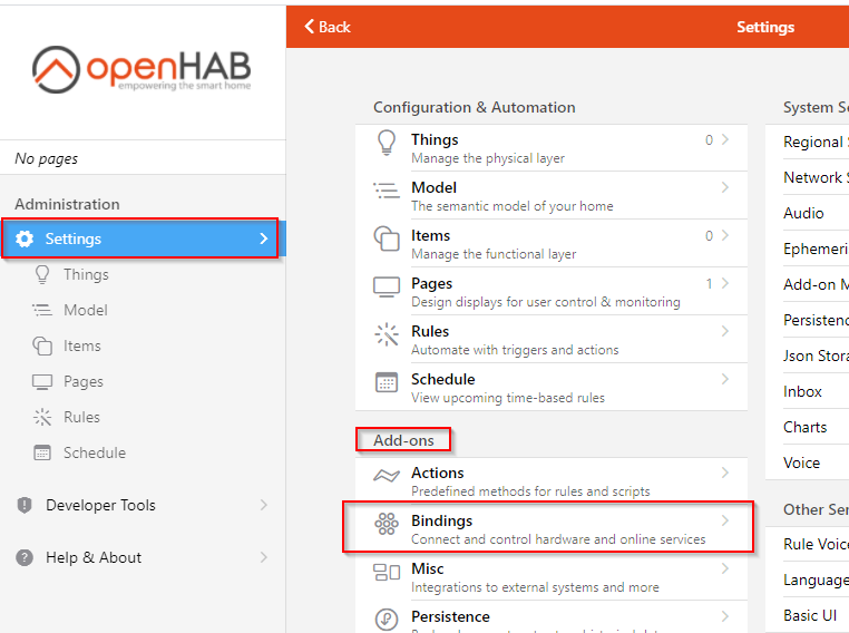

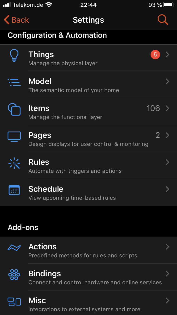

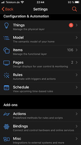

In the UI there appears to be no way to remove a binding . Perhaps I just missed the link.

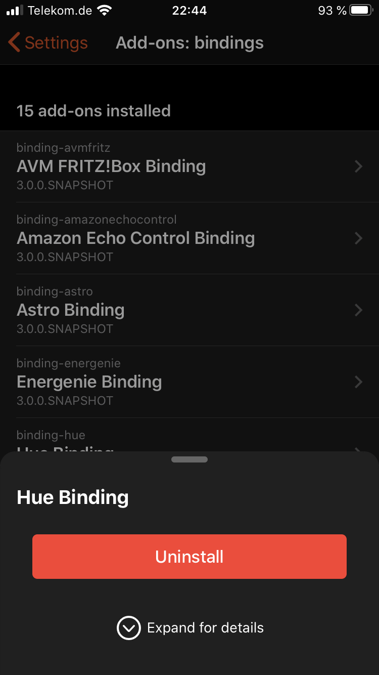

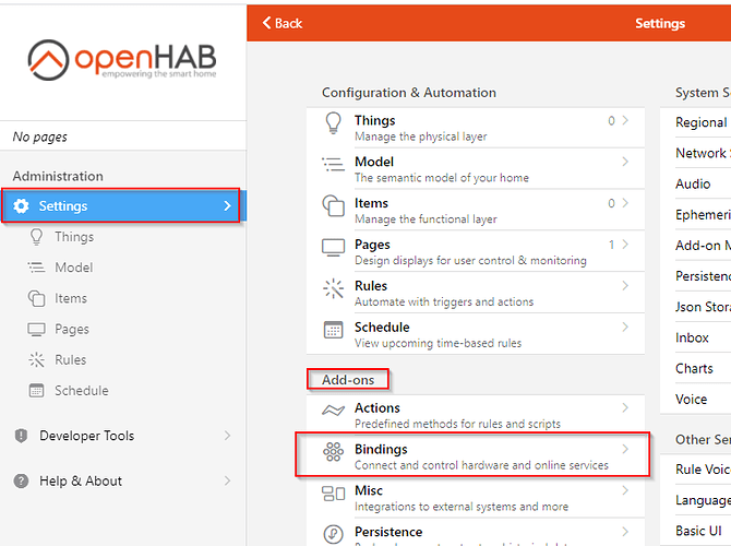

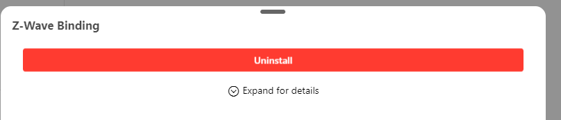

When you are in the installed bindings list, click on the binding you want to uninstall and you should see a popup saying uninstall…

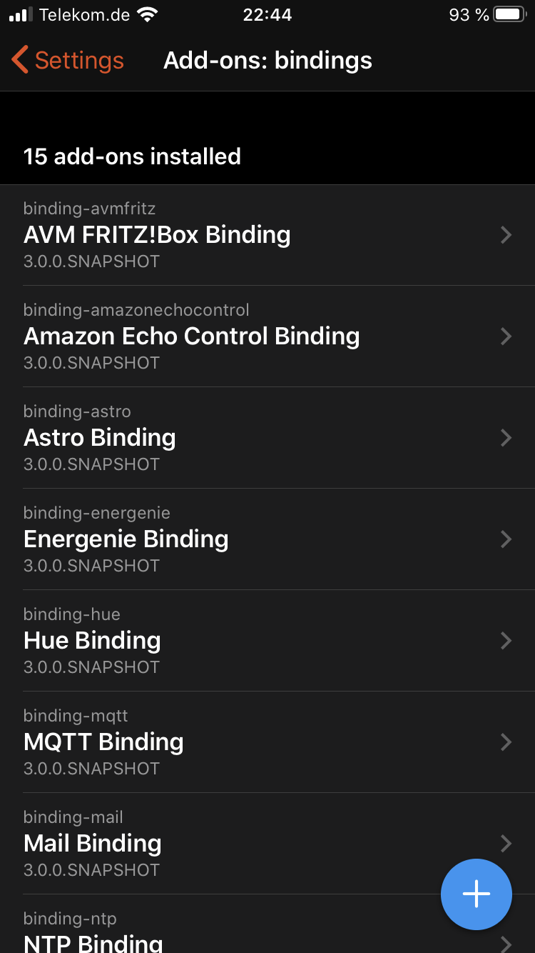

I only see that list when trying to add a Thing. I assume there is another place?
Hmm here are screenshots from my phone…
OK I found it, thanks.
