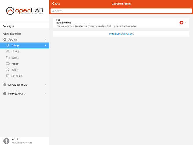

From Settings, go to Things, then click the blue “+” button.

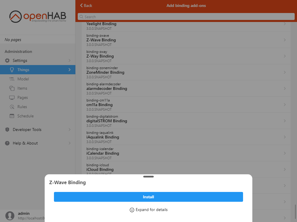

We need to install the Z-Wave binding. Click “Install More Bindings”.
Find the Z-Wave binding, click on it then click Install.
Wait for it to disappear from the list then go back.

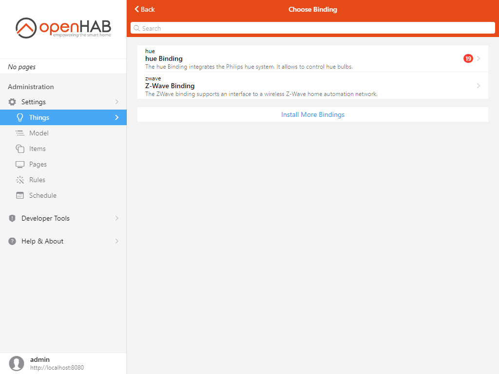

Create the Bridge Thing
Click on the new option: Z-Wave Binding.

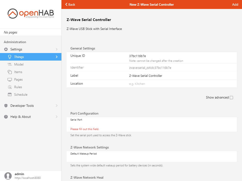

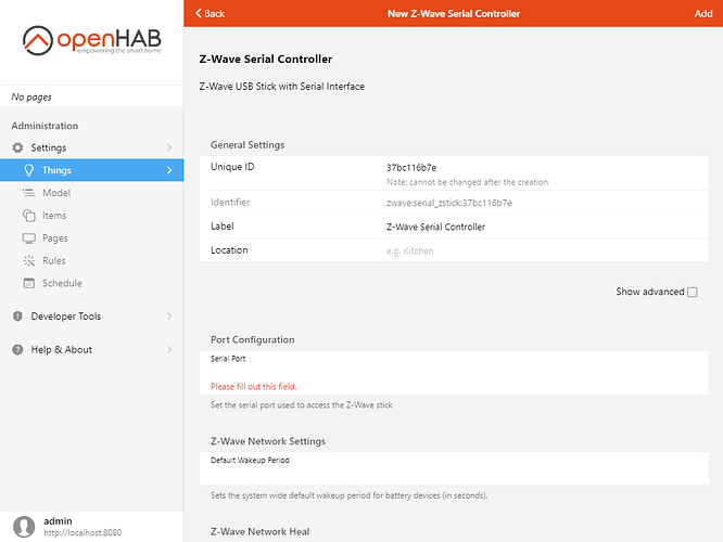

Click on Z-Wave Serial Controller to add the controller.
We need to specify one required parameter, the serial port. In certain cases, depending on your system, you will be provided with a list of options for this setting.
Choose the correct port, alter the name and/or ID of the controller Thing, then click Add in the top-right corner.
