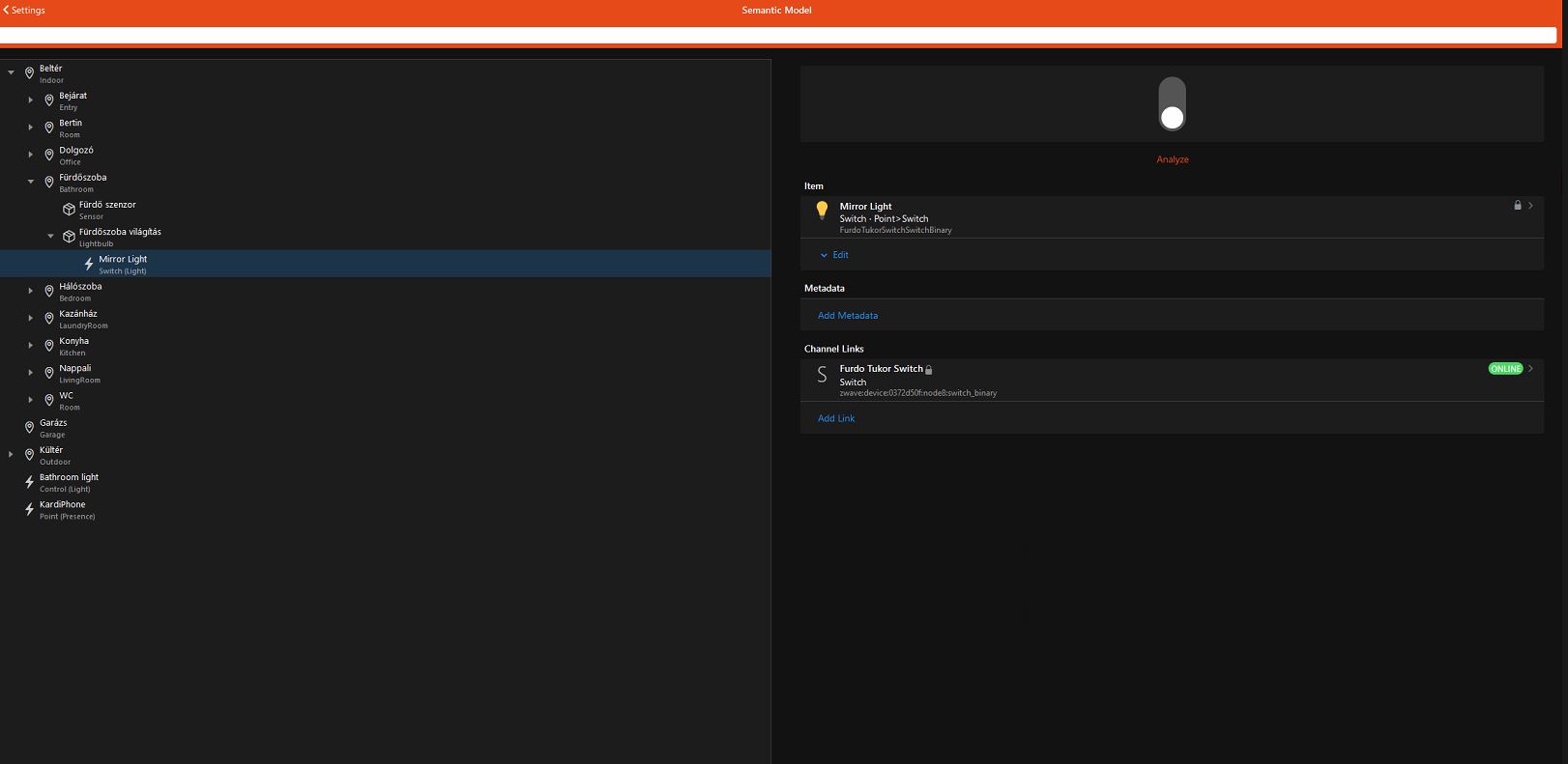

Not sure why the IsPointOf property is missing from the Dimmer light item, although it is in the same group as the Mirror Switch item..
What am I missing here? :slight_smile:
I recommend against this. It’s just not worth the effort to fight with the model in .items files.
Have you looked at other evidence for proper configuration? Does the Dimmer show up in the Overview Tabs? If you go to gBathroomLight’s page is the Dimmer shown as a member? Does the Dimmer appear somewhere else in the Model? I can’t read the screen shots but it kind of looks like it’s sitting at the bottom of the list in the model. That means that the root of the problem is the Group membership.
About all I can really suggest is to focus on that gBathroomLights Group. Watch the logs for errors. Try different ways to define the Item. Reload the .items files. Maybe even restart OH.
The item shows up in my sitemap just fine, and can be toggled/dimmed.
Also it shows up in the properties tab under the lights card.
In the model if I navigate to Bathroomlights equipment and check the properties of that, it shows that direct members are: bathroom light and mirror light.
I’m not sure what happened but now I’ve edited the tagging of the bathroom light item from [“Control”, “Light”] to [“Switch”, “Light”] then back to [“Control”, “Light”] and now it shows up as it should be.
Strange that I’ve done that for like 3 times yesterday and nothing has happened :smiley:

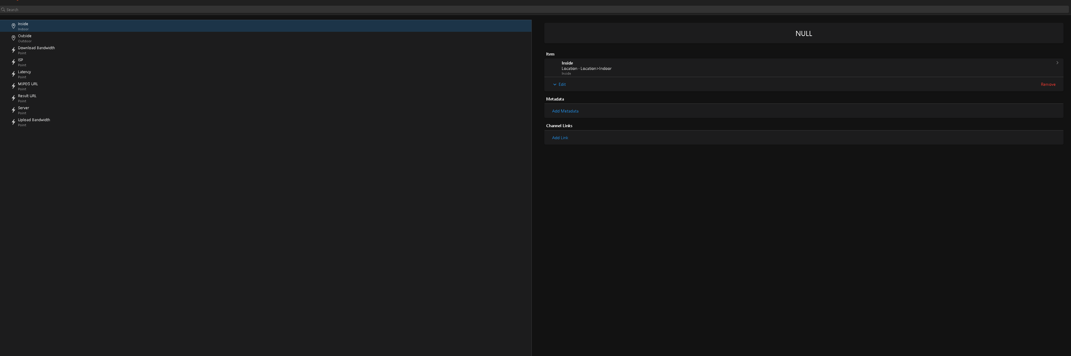

Can someone explain why i cant add further locations under Indoor, that represent rooms?
Thanks!

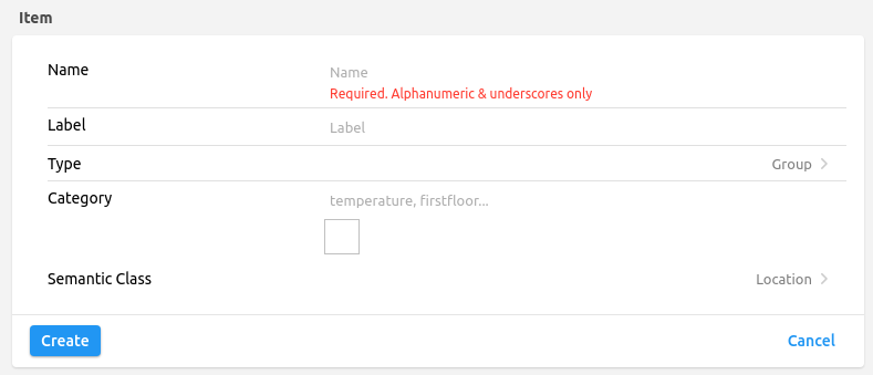

I can’t see the screen shot very well, but it looks like you created a Location type item not a semantic location. A Location Item is for geolocation data (lat/lon). A semantic location is just a regular Group Item that happens to have the one of the location semantic tags. Because your item is not a group the model page doesn’t recognize it as warranting the further location options of adding other locations or equipment.
Don’r try to create your semantic model locations through the Items page, use the Model page and click on the add location button that appears when no other items are selected in the three. That will give you your root location(s).
Thanks Justin, I’m creating it on the Model page. If you click the screenshot, it will blow up to higher resolution
I believe I’m creating a Semantic location under the model page, not under the Items page
The issue remains that you are somehow creating the wrong type of item. If you look at one of my semantic locations, you see that under the item label is says Group·Location>Building
That means this is a group item with the location semantic tag of building. Beneath that there is the whole suite of options for adding sub-locations, equipment, etc.
For the item you are showing us it says Location·Location>indoor. This is not a group item.
Did you add this location by pressing the Add Location button on the model page?
If you did, did you then change the item Type from Group to ‘Location’? Don’t do that. Leave it as a group.
The overlap in terminology between semantic location (semantic tags) and location item (item type) is regrettable, but once you remember that semantic locations are just another way of organizing (grouping) your items it makes it a little easier to keep track of what’s going on.
