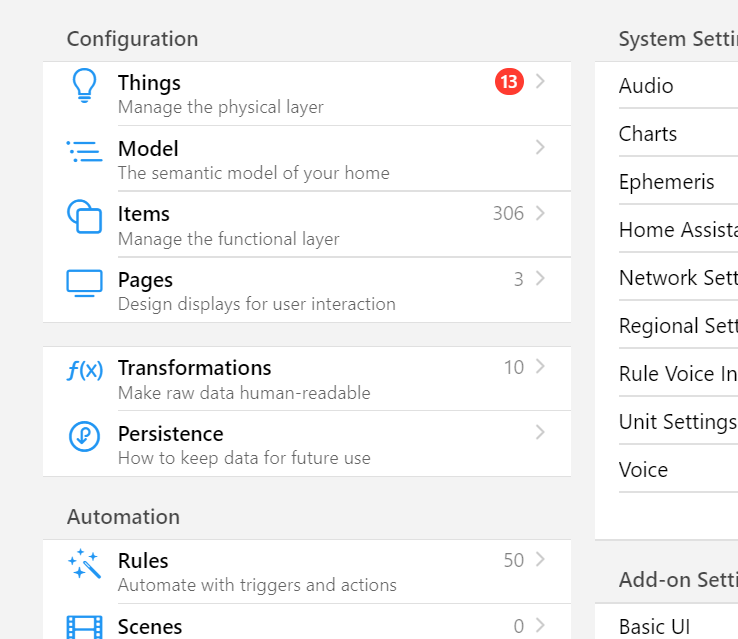

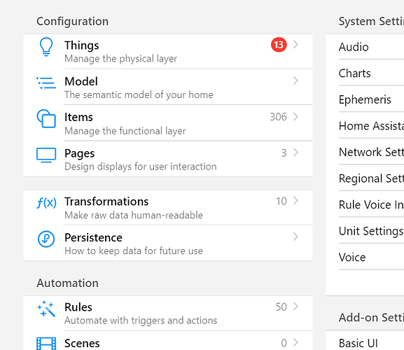

Configuration page, click on Persistence:

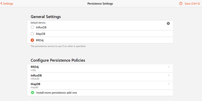

Select one of the installed persistence services to configure the policy:

All of what is available in the file configuration is also available in the UI. It is true a persistence service can have other configuration options, things like a connection string to connect to a DB would be a good example. That is to configure the connection to your DB, not to configure what gets stored in the DB. That’s what the persistence configuration is for.
