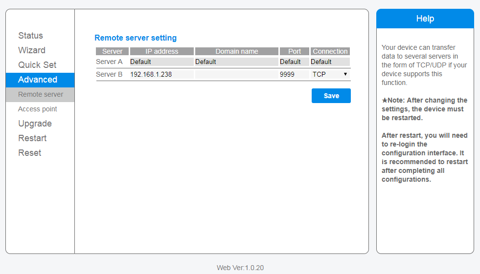

I have a Solis Wifi dongle. I can see in sceppi’s screen shot that it is from firmware 1.0.1. I am on 1.0.20 and in the general world of progress I seem to have far less. I dont have a test option and I dont have a connection protocol.
I have put in a listening IP & port and verified from another machine on the network that there isnt a local firewall blocking the port and its all fine with the exception of the logger says “not connected” even after it has connected to the ginlong monitor. I have left this for 24 hours (including a very sunny day) and still no connection.
I have tried the above MQTT solution for OpenHAB (really really would love this) and didnt work so went to basics and used nc in Linux and a simply python script and not joy. In all cases I can see there were no attempts from the dongle to open a connection never mind send data.
Anyone got this working with the newer firmware?
And the status page says:
Remote server information
Remote server A Connected
Remote server B Not connected
