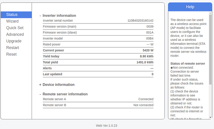

Have a Ginlong Solis 4G 3.6 and like to use the second server address. However I have no knowledge about LINUX, Rpi, Python etc. Just a bit about Arduino and ESP8266 (and C). So I have an ESP8266 configured as webserver. The second Solis port is configured with the IP address and port of the ESP8266.
Nothing is being received and the status of “Remote Server B” remains “Not Connected”.
Anybody done this before ? Any suggestions?

I’m having the same issue. I have ver 1.0.23 and server B is showing Not Connected. I setup a SBC (AtomcPi) to listen to the port using the linux NC and nothing is received. I used NMAP from another PC to test the port and it did work, so NC was expecting the signal but the inverter wasn’t sending anything. :thinking: :thinking:

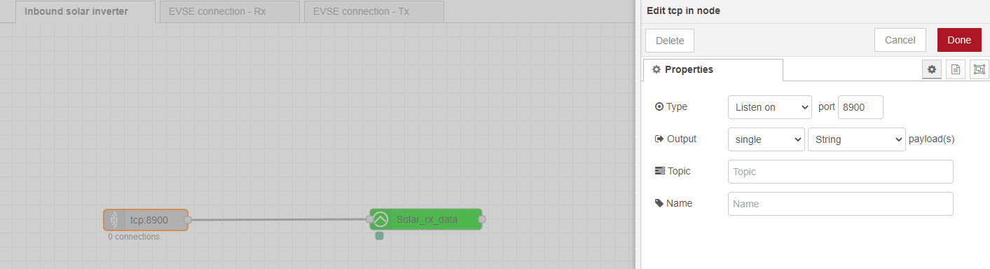

I am capturing the data from my Solis using a TCP node in NodeRed because there is currently no TCP binding in OH3 to receive the data as a “second server”.
Roughly this is the way it works:
Set the second server in the inverter to the IP of the NodeRed server with a static port number.
Configure a TCP node in NodeRed to capture the data from the inverter.
Configure an item node in NodeRed to send the data to openHAB.
Process the incoming data with a rule which updates the items.

Inverter programmed with IP of OpenHAB server and port 8900 as “second server”

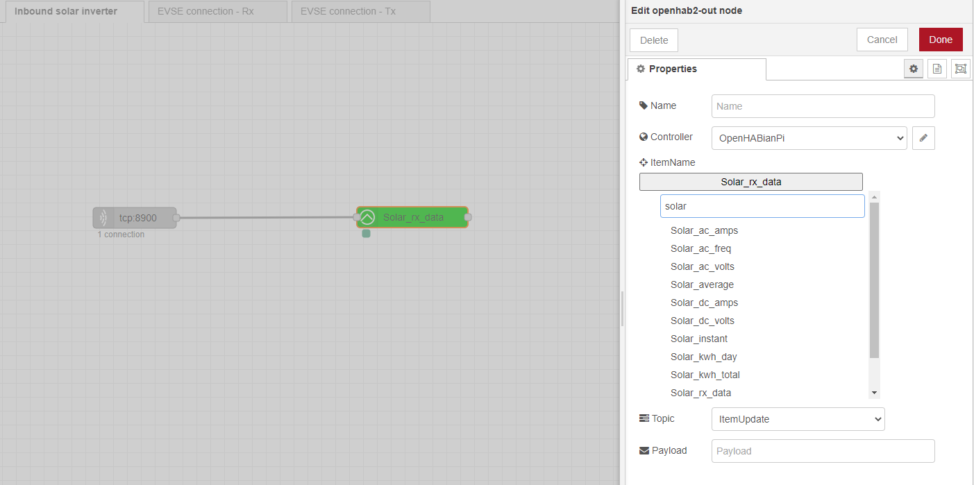

NodeRED TCP In node:
Connected to OpenHAB2 out node:
Items:

I also have the same issue, web version 1.0.23. remote server B in not connected status whatever I set the “remote server” page under the “advanced” menu.
I also confused by the setting of the “ip address” and the “domain name”.
What’s the use of the domain name? ip address looks enough for data logger to find the remote server.
Is there anyone succeed with the remote server B setup?
