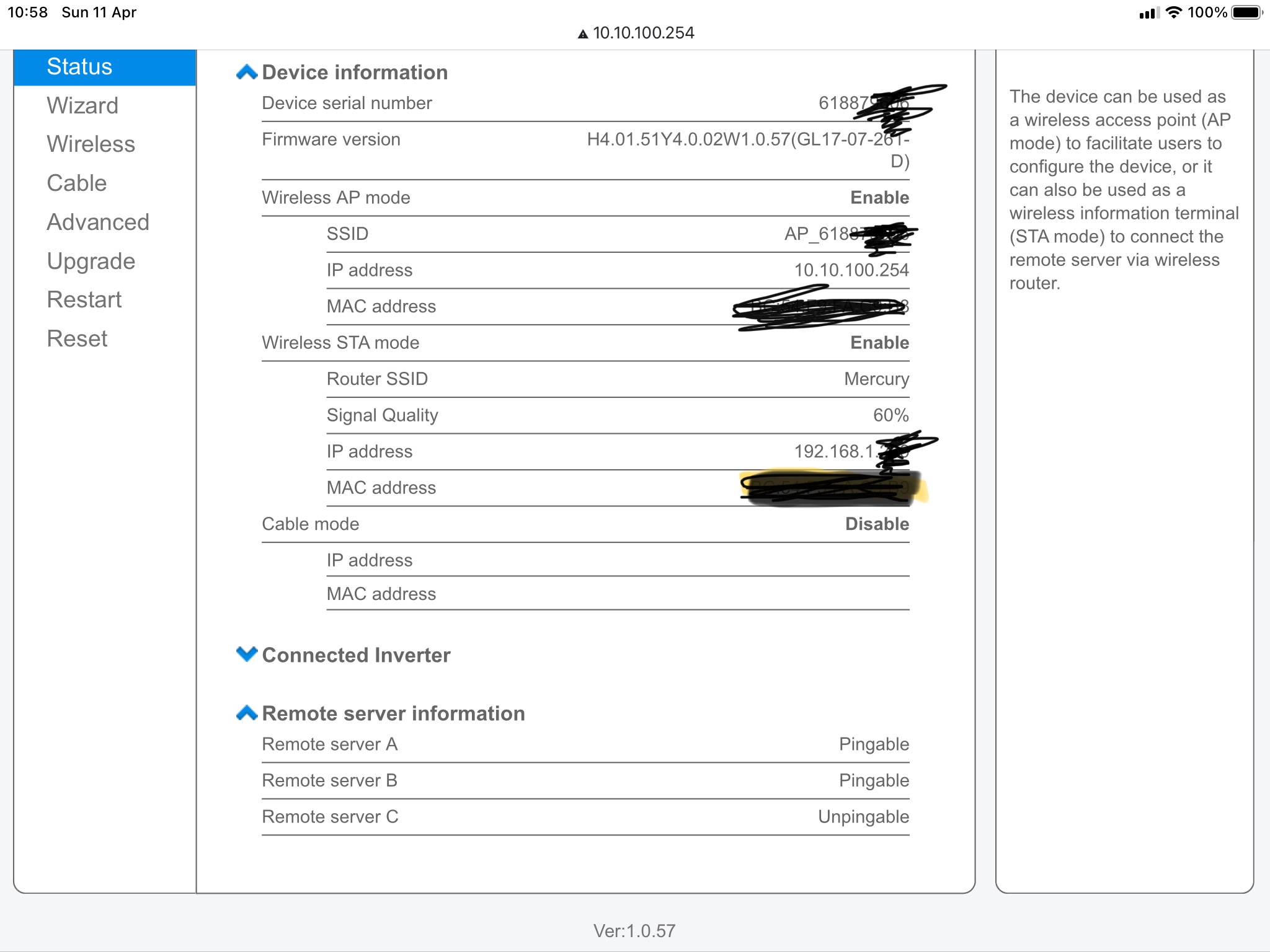

I assume you need a server for the logger to find and connect to. I capture the incoming string with NodeRed (see post above). My logger is version 1.0.57 so I don’t know if that makes a difference.

Server B does not work under some firmware versions. Instead you can redirect the output entirely by going to /config_hide.html

It is strange my version is 1.0.23 while yours is 1.0.57.

Firmware for mine is v1.0.6
Andy would appreciate any input you can provide
Just checked, same here according to F/W version 1.0.6 (tag at bottom of screen is misleading - says 1.0.1!)
