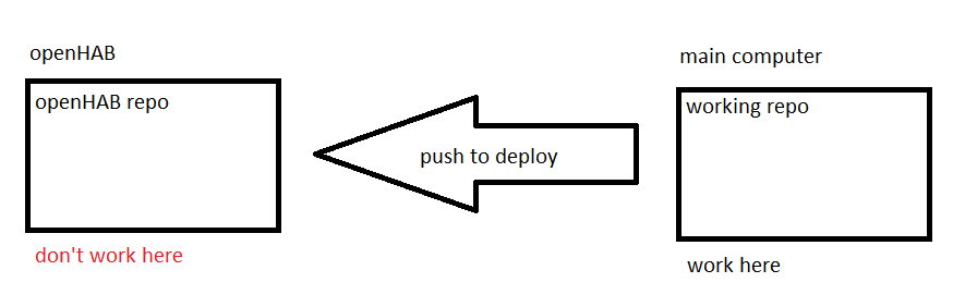

Push to Deploy
main computer: If we now change stuff in our working repo, commit this stuff and want to push it to our openHAB repo, we will get an error message:
$ cd /path/to/working/repo
$ cd config/rules
$ vim example.rules
$ git commit -a -m "Did some changes to example.rules"
$ git push
The reason for the error message is, that git isn’t happy with pushes to non-bare repositories - reasons / details see here.
openHAB: To change that we have to set a flag in our openHAB repo:
$ cd /etc/openhab2/
$ git config --local receive.denyCurrentBranch updateInstead
Now your openHAB repo will accept pushed changes and will update the content of your config folder accordingly.
This can lead to trouble and lost changes if you have non-committed changes in your openHAB repo. If you set this flag change files only anymore in your working repo!
Remark: If you don’t want to push to deploy, you have to make the working repo available as remote repo in your openHAB repo and to pull, merge and checkout changes manually.
Finished
